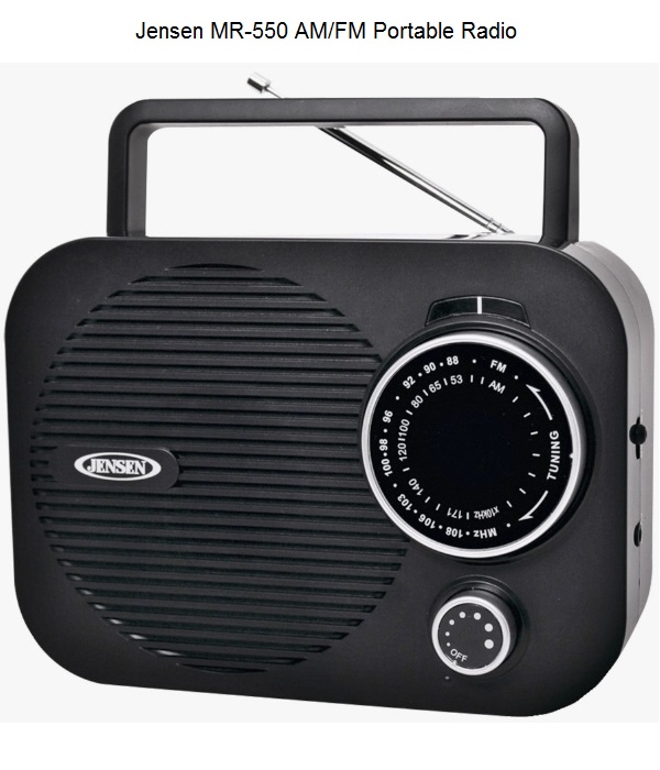

I suggest you use a battery operated portable radio tuned to the AM broadcast band to hunt for sources of the interference. Most portable radios have a built-in antenna that is directional which might help you in hunting for a source. This is the one I use:
If you still can't locate the source of interference, or are unable to do anything about it even if you do know the cause, I suggest you listen to FM. That's what my sister does; she likes NPR.
