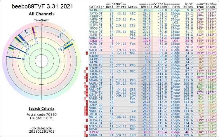

Hello, beebo89; welcome to the forum.
Thank you for the signal report. It appears to be an approximate report that might not be accurate for your actual location in New Iberia, LA. The location for that report is near the intersection of Center St and Spanish Towne Blvd near Lowes and Social Security Admin.
The database used to generate TVFool reports is out of date, so I did a report for that same location at rabbitears.info (the lowest antenna height it can do is 13 ft):
https://www.rabbitears.info/searchma...tudy_id=239475

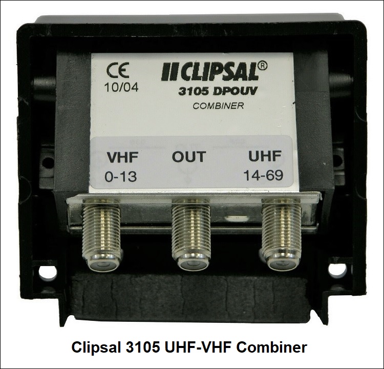

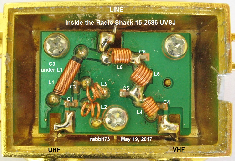

I would like to have both a VHF and UHF antenna connected at the same time, but I understand that I would need some kind of combiner or diplexer, and I know nothing about that stuff.
The correct device to combine a UHF antenna with a VHF antenna is a UVSJ (UHF/VHF Separator/Joiner) which is indeed a diplexer.
https://store.antennasdirect.com/UHF...Combiners.html
This is also available, but I haven't tested it:
https://www.amazon.com/Weatherproof-.../dp/B0744NTJX8
You can also try eBay for the Radio Shack 15-2586.

Thanks for the reply. The rabbitearsinfo graph is much more accurate, thanks.

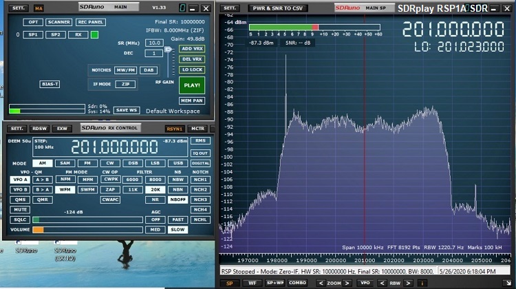

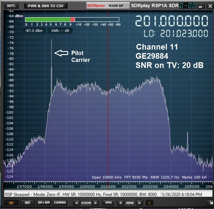

I have a GE 29884 antenna in my window that has a VHF aluminum folded dipole, but that might not have quite enough gain for your location. The folded dipole is about 29" long. I use it for Channel 11:
The signal looks pretty good on my SDR, in spite of the high noise level on VHF at my location:

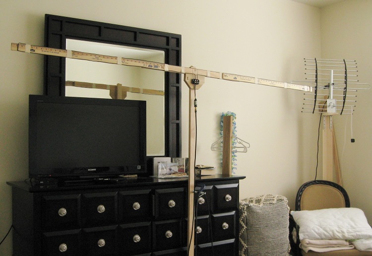

I made a folded dipole for channel 3 using yardsticks and THHN 14 gauge insulated solid copper wire.

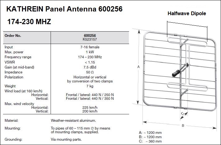

You have departed considerably from the example I posted. The example is two stacked halfwave folded dipoles.
A bowtie antenna uses fullwave dipoles:
If you want to use the bowtie design, it would need to be TWICE as wide.
The bowtie antenna is derived from the collinear array, The bowties instead of the straight elements gives greater bandwidth.

I guess I didn't make it very clear. You can not wire your 4 halfwave dipoles together like the fullwave dipoles in a UHF bowtie antenna and expect it to work properly.
Two stacked halfwave folded dipoles with a reflector will give you about the same gain as 4 stacked halfwave dipoles without a reflector; about 6 dB.

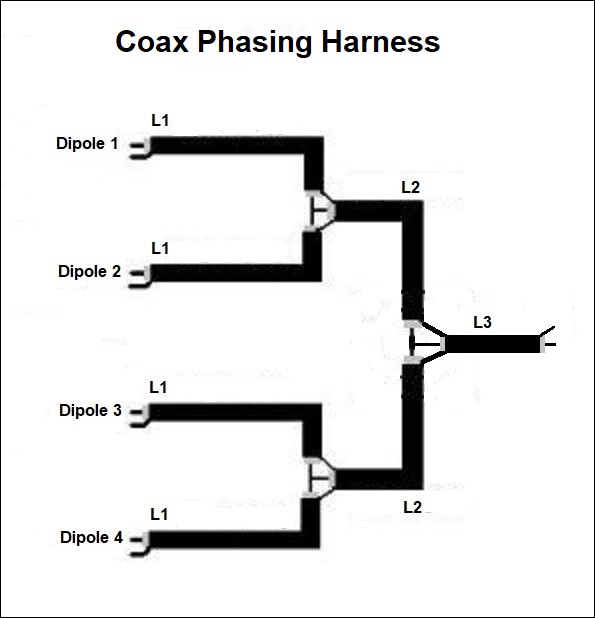

Old 7-Apr-2021, 12:36 AM   #16
Originally Posted by beebo89 View Post
Oh, I get it. I saw the 2 stacked folded dipole you posted. I did not realize that that was the optimal way to go with folded dipoles, similar to a small antenna is good, a bigger antenna is better. Making it with 2 instead of 4 will be easier and quicker. Thanks for all the help, it is greatly appreciated.
In theory, it is possible to make a coax phasing harness for 4 stacked ordinary dipoles, but it is quite involved. Different types of coax are used and they must be cut to specific lengths according to frequency to make 1/4 wave matching transformers.
It is also possible to construct a power divider. Here is one for 2 antennas; one can also be made for 4 antennas.
https://www.qsl.net/dk7zb/Stacking/splitter.htm
I tried to pick an easier way for you.
