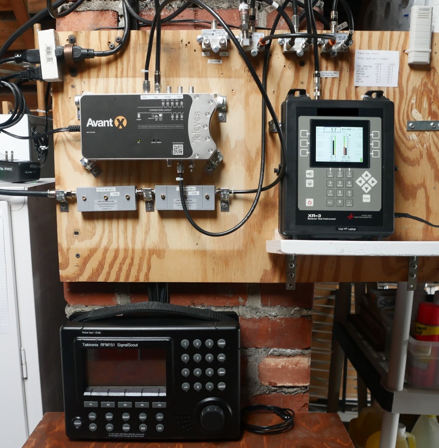

Avant-X Programmable 4 input distribution amp from Televes
I was intrigued by this since it is such an unusual device. While there are plenty of preamps, even some with more than one input, for the most part almost everything is 'set'.
This is NOT a "preamp" It's designed for indoor installation to combine up to 4 antennas with the option to use (what is labeled) a CATV input as a 5th input either for an antenna that doesn't need any 'filtering' or more likely, a modulator to add another signal source; CCTV DVR, Media Player, HDTV DVR, DVD or BD player).
It's not 'cheap'. But, what it does, or what it can do, if you price MATV equipment, even low end, it could be a bargain.
Conversations I have had between the three of us have enlightened all of us. There are details that really aren't documented in the very limited 'quick guide' Televes provides. Which brings me to here.
Links to this and it's software and the source of my purchase which I recommend very highly;

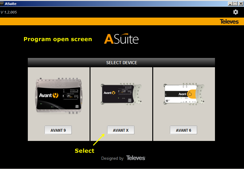

ASuite software;
Their software was not easy to find on their website. It was not under the product page, but under 'Software';
https://www.televes.com/us/software?busca=asuite
This requires Java RE v1.7.0 either x86 or x64 v1.7.0.51. This is not stated on their web site. I didn't find this out until I tried to 'run' the program!
It also requires M$ Visual C++ 2008 (which is installed from the program if the O/S doesn't already have it)
I did run into a problem in XP Pro in one of two Laptops that JRE didn't install properly with no solution.
Installed program reports to be 118MB. Actual folder is 139MB

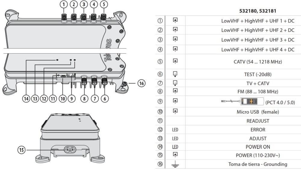

The AVANTx has 4 independent input preamp stages (wideband up to 608 MHz) and then the set of 32 filters which are programmable with the different wanted channels. If a channel is blocked, it enters the input preamp, but it is blocked in the filters and it is not present in the output wideband amplifier, where all the signals coming from the 32 filters are boosted altogether.
The main CATV+TV output is the mixed output for the CATV mix input and what comes from the antenna side of the Avant. The way the Avant adjusts the filters is by reading the power level there as it goes through the frequencies and adjusts each filter width and gain. For this reading to be accurate and the adjustment to be satisfactory this output needs to be correctly adapted and loaded with a 75 ohm load, otherwise there will be impedance mismatches, the power reading will fluctuate wildly and the filters will be totally unadjusted.
See the attachment for the port configuration of the device

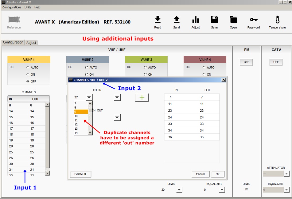

Regarding reassigning stations to other physical channel numbers.
I see a possible problem regarding devices when using outside party 'Guide data'. Namely TiVo recorders. Rovi (that owns TiVo and also supplies the data for their 'Guide') has their 'system' programmed to expect stations to be on predefined physical channel numbers. During the 'repack' when everything was in 'disorder', stations that 'moved' earlier than expected the 'Guide' data did not show under the new physical channel number. It still did show on the old allocation, but not under the new assignment.
IOW's you could not record a program on that channel without manually entering in the channel number, start & stop times, AKA 'VCR' style. They changed their regional data to now include stations in the market you are in. Of course there are many mistakes in this and many stations would be out of range for most owners given the lack of decent outdoor antenna(s) or just being in a poor location. I guess to make things easier for 'Joe SixPack' where an antenna scan almost isn't necessary (but still required).
Moving the station to a different physical channel number I would expect would do the same thing.

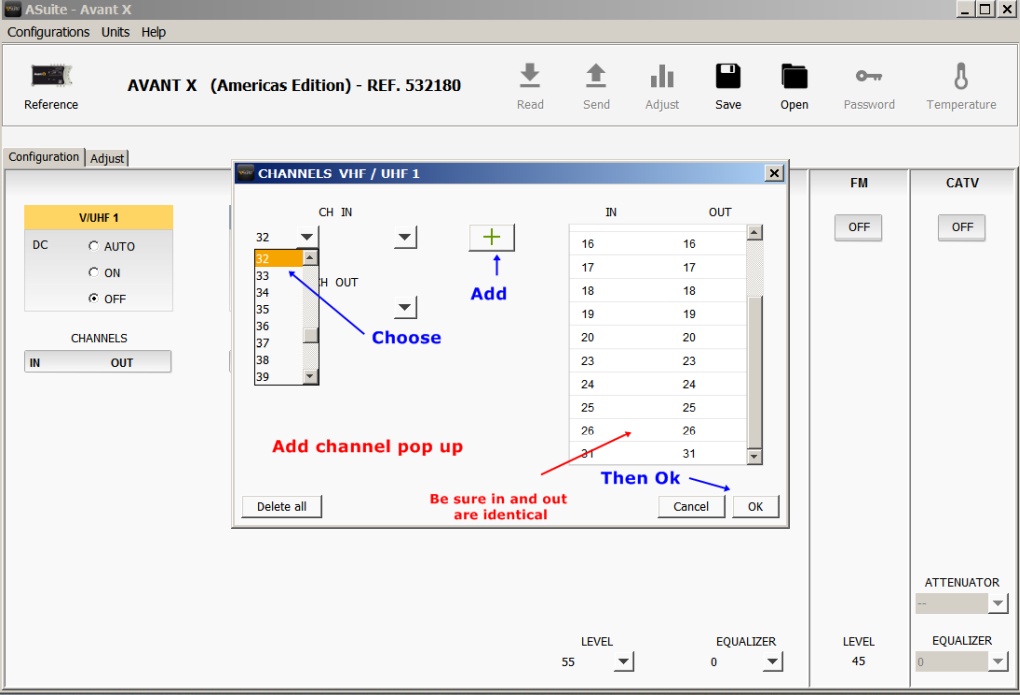

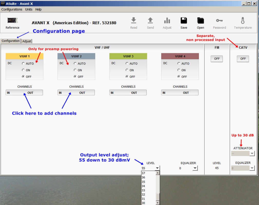

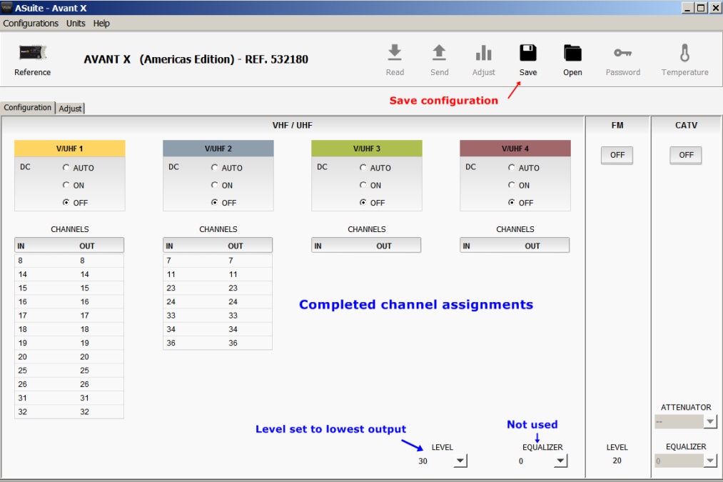

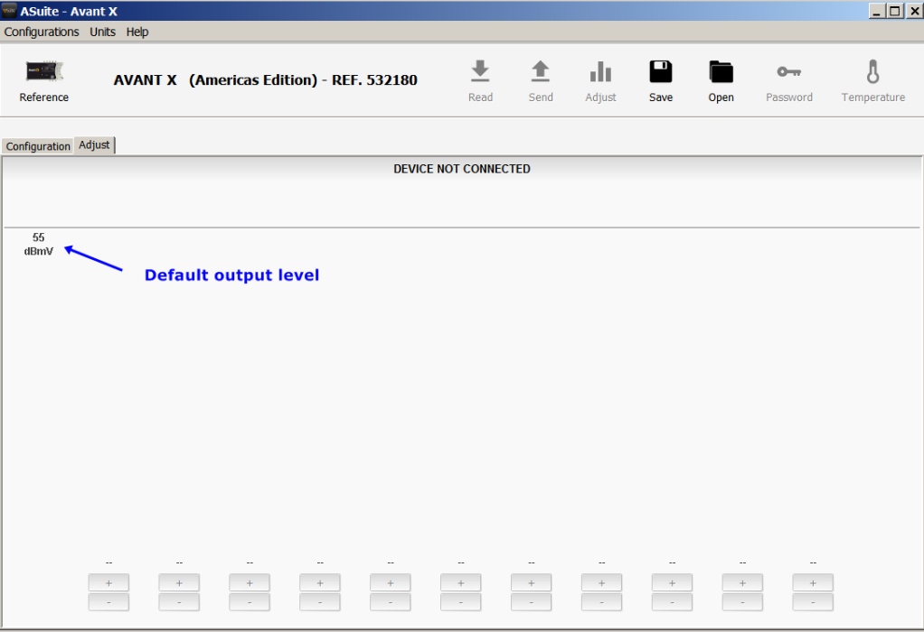

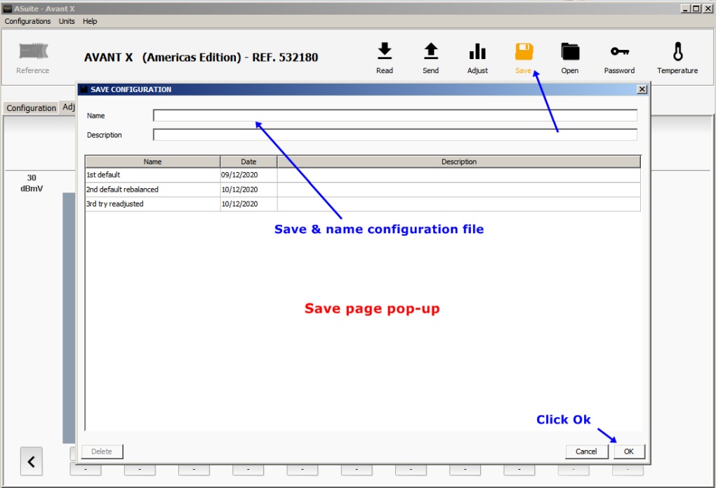

Attached are screen shots of the 'Custom User Guide'.
The entire Guide in OpenOffice (.odt) format is here (the upper right corner of the page has the 'Download" link for the file);
https://app.box.com/s/v1dulzacoo40g9jlfi3w7rcgfm5ppc84

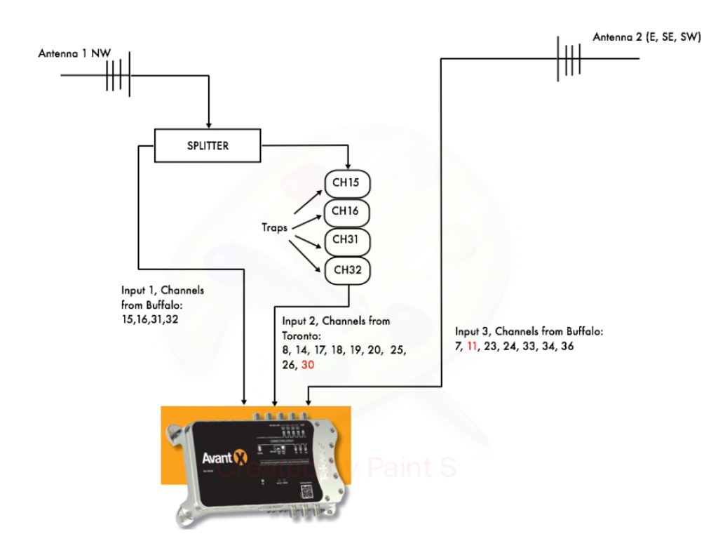

The AVANTx can accept signals in its input ranging from -40 dBmV to +20 dBmV, that is to say, 60 dB. The block diagram of the AVANTx, which is depicted as follows, is helpful to understand why the balancing cannot be achieved.
The AVANTx has 4 inputs. Each one of the inputs has a first block of analog filtering, VHF high&low and UHF, after which a high margin amplifier prepares the whole set of received signals to the digital filtering block. After these 4 amplifiers, and before the digital filters, there are 4 Analog to Digital Converters (ADCs), one per amplifier, that give off the digital samples of each input to the digital filtering block.
This digital filtering block encompasses 32 filters, which are programmed by the user depending on the channel map in the location. The AVANTx can operate without channel conversion (i.e. same output as input channel) or performing channel conversion, moving the output channel to a different frequency. The digital filters bandwidth depends on the presence/absence of adjacent channels to the wanted channel. If there aren’t channels, this bandwidth is wider.
The problem of this schema is that the AVANTx won’t be able to cope with input imbalances higher than 30 dB in the same input1, because input 1 receives signals from Buffalo and from Toronto. Due to the high level of the signals received from Buffalo, the amplifier attenuates input 1 instead of boosting, not to overwhelm the ADC. That makes that the low level signals received from Toronto are attenuated, which makes the balancing of the whole set more difficult.
Ideally, to solve the problem, we should be receiving the signals coming from NW from two different antennas, separating Buffalo and Toronto. However, this is not possible, as the beam width of reception is very narrow.
The solution to use traps to attenuate individual signals in channels 15, 16, 31 and 32 seems therefore the only option reasonable not to override the input ADC of the AVANTx. However, the frequency response of the traps (picture below) added to the fact that channels 15 and 16 are adjacent to channels 14 and 17 coming with low levels from Toronto affect the level of these latter, as the trap is not strictly speaking narrow band.
Therefore, the use of traps attenuates effectively the higher level channels, yet impairs the adjacent ones. In the scenario we have, the trap in channels 31 and 32 would be useful, impairing channel 30, whilst the use of traps in channel 15 and 16 impairs channel 14 and 17 from Toronto. There is a channel 33 in use, yet received by the second antenna pointing to SW. Therefore it would not be affected by the use of the trap 31-32, provided that this second antenna uses a different input of the AVANTx to process the channels.
(For the following, see the attachment)
Input 1 in AVANTx would process the channels from Buffalo with the highest received levels. If needed, an attenuator could be placed in order not to override AVANTx input, as the level could reach the maximum of +20 dBmV. The channels from Toronto are disregarded in this input.
Input 2 in AVANTx would process the channels from Toronto. It is necessary to attenuate the levels of the channels 15,16, 31 and 32 by using the traps. If possible, the frequency response of the traps could be modified in order to achieve a minimum impair in the adjacent channels. However, channel 30 is extremely difficult to process, as the imbalance regarding nearby channels is too high.
Input 3 in AVANTX would process the channels from Buffalo received by Antenna 2
Attached is the proposed config plan for the 3rd input. Instead of using a 'splitter', I'll use a 16db 'tap' to offset the loss on the output for the weaker Canadian stations.

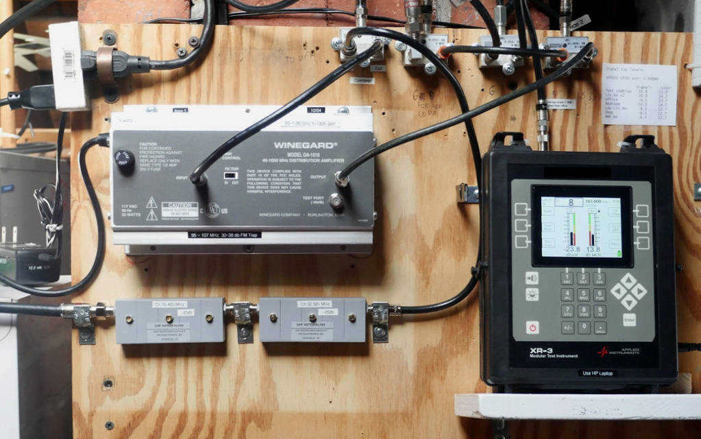

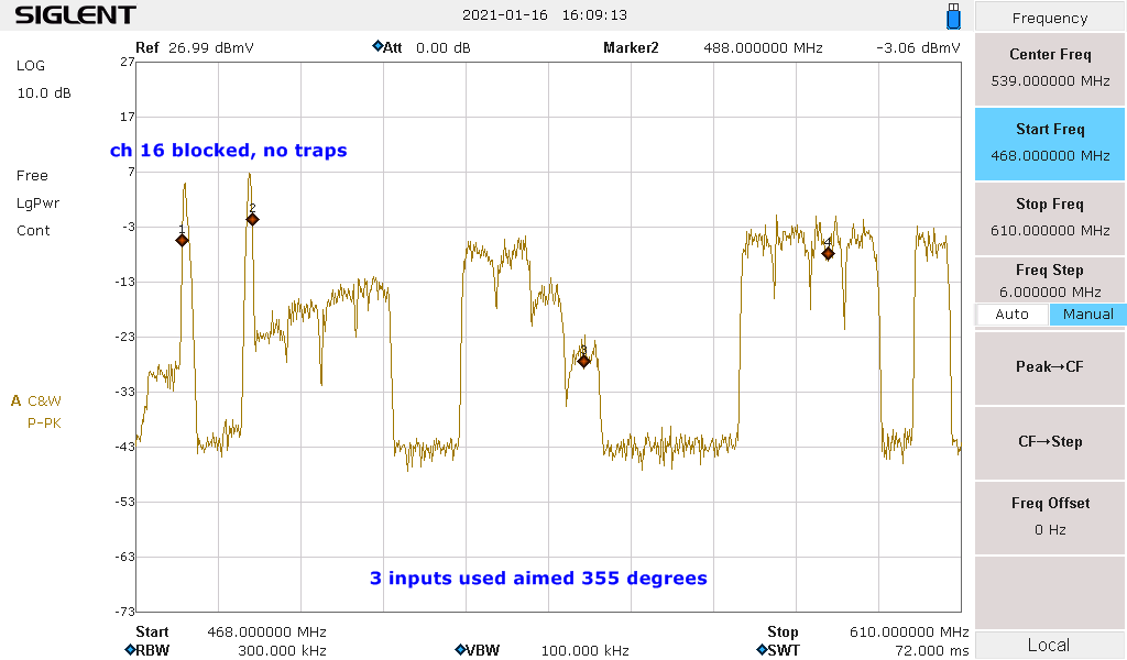

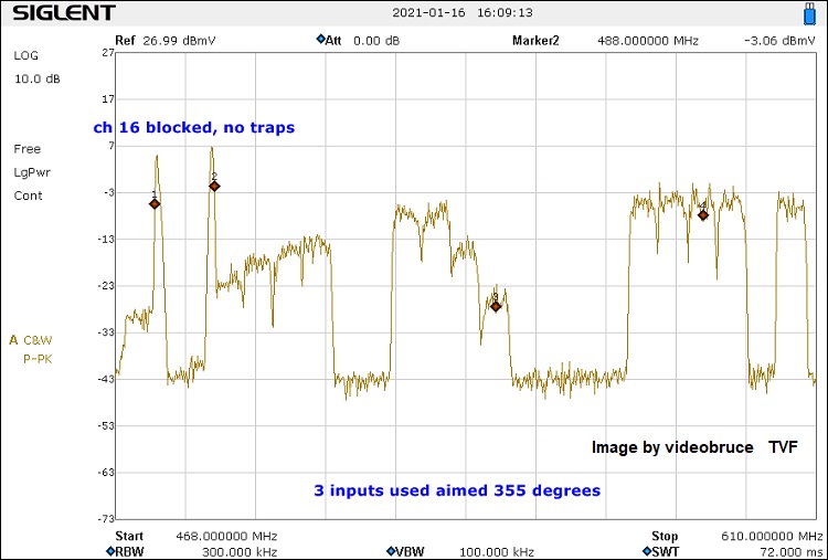

Problems
From my experience tiring different DA's (distribution maps) in place of my long term Winegard DA1018 DA (18db gain, adjustable), fpr example, Winegard's 36db version was way too much to handle the excessively strong signals that I have had to deal with for well over 25 years. First with analog, then digital, now with a UHF spectrum that was reduced a THIRD time (originally 82, then 68, then 50, now only 35 channels) cramming everything much closer together.

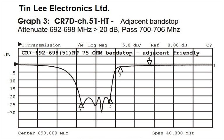

Single channel tunable traps (filters if you prefer) are the only solution. To be clear, this has to do with stations coming from the same direction within say +,-20 or so degrees
The outstanding problems with this product are excessive amplification, inability to handle differences in signal level over 25db on adjacent channels and filter width. Some wer addressed here in one of his emails, the others were not;
My point;
From page 5 of the “Product Sheet”;
Recommended input range....dBmV.. -20…40
Gain regulation................... dB......... 0…30 (auto)
That is not the clear, the term “Input” is not used in the line for "Gain regulation", assuming that line is the difference issue.
His response;
What the AVANTx cannot do is to balance a difference of 30-35 dB IN CASE OF ADJACENT CHANNELS. If the channels are not adjacent, there is no problem. The reason is because the filter, albeit digital, takes a vestige of the upper and lower channel. If the level is very high, spikes appear, as you saw in your graphs. See below channel 17 with a peak which is a vestige of high level channel 16. Notice that the level of channel 17 is lower than 18, 19 and 20, yet the power detected is the same, because of the peak of adjacent channel 16.
1. Excessive gain:
Even at the lowest output which is 30db, with the three 'problem' stations (as I call them) still overload the Avant-X with my custom traps. Without the traps , I loose at least five channels. Period! The signal is there, but numerous factors prevent tuners from locking on to them.
If that was reduced down to 20db, I would be willing to bet most of that issue would go away. Putting a 10db 'pad' defeats the purpose of this in the 1st place. using the 'test port' doesn't solve the problem either since the 'damage' is already done before the output.

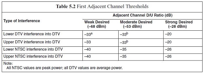

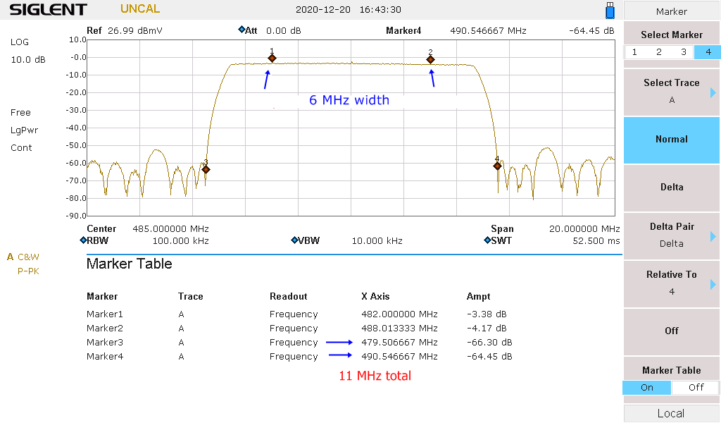

2. Filter bandwidth:
The Avant-X is based on European TV channels which is 8 MHz derived from PAL & SECAM systems (with some being 7 MHz).
This can cause problems with adjacent channels here that are overpowering the wanted channel due to (what I call) 'leftovers' that aren't attenuated enough affecting the neighboring channel. Level differences over say, 25-30 db can cause issues depending of the specific situation. Even with the single channel traps, which help, it's still not enough.
https://www.britannica.com/technolog...h-requirements (scroll to bottom of the page)
3. Non-controllable AGC (to a lessor extent) ;
I was never a fan of 'auto' anything, especially when it comes to electronics. There is always a compromise. While it can work, many times it doesn't, or doesn't work correctly. Not having control can lead to other problems. ALC, AGC, for audio or video, Auto-Iris, Auto White Balance Auto exposure for cameras (film or video) and AGC circuits in RF amplifiers. It's all a compromise and how the circuit was programmed.
Reducing some levels while amplifying others to 'flatten out' the spectrum sounds good on paper, but if that includes cranking a weaker station excessively or increasing a channel that was 'blocked with that 'left over' can cause issues.
While having a +_ 3db level adjustment is better than nothing, I don't feel that is
adequate enough.

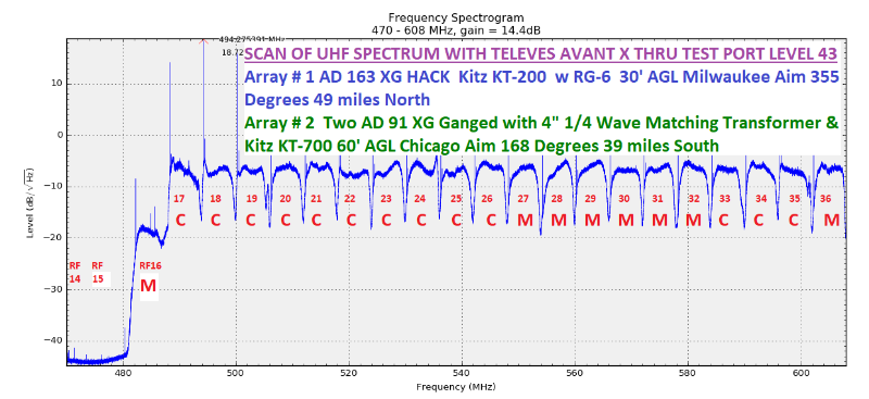

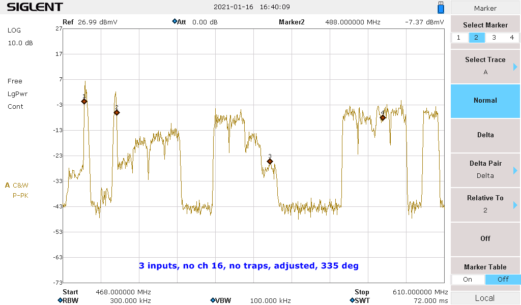

Note,

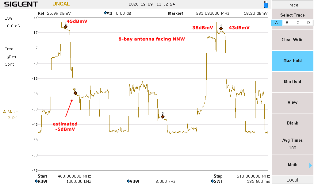

Take a look at these attachments of ch 15 & 16 and the text in them.Then look at the last attachment; a single channel and it's width at the markers.
To put things in perspective, look at the 3rd attachment. That shows the level differences here.

Back to plan A, it's a 'no go', it's not the 'silver bullet'
What looked good on paper, wasn't in the field. After experimenting with this on my bench, not where the device would be placed, I finally did install it in place. Results overall were about the same except for a few 'variables' due to the additional 25 or so feet of additional cable between inside locations.
Splitting that one antenna feed via a 16db 'tap' to limit loss of the 'wanted' stations, then reduce the overload of the unwanted 'problem' stations using the 'Tap' out, apparently just added more complexity.
It made the one wanted station somewhat worse. So I went back to just using 2 inputs, but that just got me to where I was before this entered the picture.
This gross signal difference (around 40db between adjacent channels off the antenna) is way too great for this to handle, even with the 20db reduction of that after my traps. Compounding that is the 'slop' left over of the offending adjacent channel from their filters too narrow filter 'shape factor'. (There is a 'wide' and 'narrow' shape factor that is based on if there are adjacent channels active or not)
The Avant-X filters have a tighter 'Q' factor then my custom 'PAR' 'traps' I have (which is good), BUT, the incorrect width doesn't get rid of enough of the adjacent 'haystack', or lets too much empty spectrum in.
Now, having said that, there is a fine line (almost literally) between just how tight a filter/trap is. Frequency and cost come into play. The 'math' is above my pay grade, but since I have 20+ years of tuning traps (as I call them), it's not just a 'art', but a major math problem in design. It's a classic case of "Robbing Peter to pay Paul" between attenuating an adjacent channel while trying to persevere the wanted channel. It really can't be done fully, it's all compromises.
I have proved it more than once, without my custom traps, this would of been completely un-usable, as I stated earlier mostly due to excessive gain and filter width. I LOOSE channels including one VHF (which I can only guess it's because of noise, but that is just an educated guess), not because of any adjacent channels or excessive signal strength. That alone is a deal killing as those custom traps were almost the cost of this.
When I went back to my existing setup (the Winegard DA), two of the stations that were missing, locked back in. That was enough and the two months of fighting with this to get it to work. It was returned. I just couldn't justify the cost in spite of the time I put into this.
Attachments;
Below are pics of the testing, then the final setup in the attic, (not a crawl space) and a scan of the 'traps' that allow to Winegard DA-1018 DA to work where the Avant-X didn't. (The double trace was the traps flipping the order to see if that mattered, the 'dips' are ch 15 & 16 then 31 & 32)

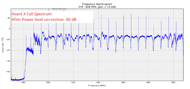

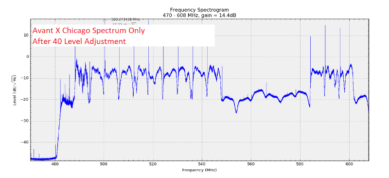

Avant X further reading
I was lucky enough to get one of the very first Avant Xs. I started a Avant X Facebook group for those interested.
https://www.facebook.com/groups/3535...849/?ref=share
Also I started a threads on AVS for those interested:
https://www.avsforum.com/threads/ava.../post-60006476
I have lots of information and spectrograms.
File Type: png received_880344132474686_copy_800x366.png (62.4 KB, 7920 views)
File Type: png received_335256584171176_copy_800x367.png (66.8 KB, 7877 views)
File Type: png received_237768863855484_copy_800x376.png (70.9 KB, 8017 views)
File Type: png received_745320559614587_copy_800x367.png (104.6 KB, 8031 views)

Then to sum it up you are 40 & 50 miles from any of the xmitters with high gain antennas with no real overload conditions. Is that correct?
If so, then the Avant-X would be able to handle that. How about what the spectrum looks like directly off the antennas? Also, how about narrowing up the spectrum for 'groups' of channels?
Separate question, can you confirm a software glitch where the 11th channel position on each page (the one furthest to the right) can NOT be manually adjusted + - 3db?

Old 5-Feb-2021, 2:26 AM   #18
Is that azimuth based on True North or Magnetic North?
Channel 15, CHCH, is 476 to 482 MHz, 291.4° True, 301.9° Magnetic
Channel 16, WNYO, is 482 to 488 MHz, 324.1° True, 334.6° Magnetic
Channel 17, CIII-41, is 488 to 494 MHz, 330.9° True, 341.4° Magnetic
Originally Posted by videobruce View Post
The outstanding problem is differential in signal level.
His response;
The 2nd problem is the width of their electronic channel filters.
On adjacent channels, the width is the narrowest of the two widths presently available. Take a look at these attachments of ch 15 & 16 and the text in them. Note, This is the 'vestige (residue, so to speak) that is 'left over' from the carriers of those two channels.
To put things in perspective, look at the last attachment. That shows the level differences here.
https://www.rabbitears.info/searchma...tudy_id=192356
Thank you for the careful thorough tests of the Televes Avant-X at a difficult reception location.
Excellent scans with the Siglent SA. What model is it?
File Type: jpg videobruceTVFsiglent07CH16blocked_2.jpg (93.1 KB, 8063 views)

Old 6-Feb-2021, 6:43 PM   #19
Now, having said that, there is a fine line (almost literally) between just have tight a filter/trap is. Frequency and cost come into play. The 'math' is above my pay grade, but since I have 20+ years of tuning traps (as I call them), it's not just a 'art', but a major math problem. It's a classic case of "Robbing Peter to pay Paul" between attenuating an adjacent channel while trying to persevere the wanted channel. It really can't be done fully, it's all compromises.
At the present time, are you able to receive 17 that is adjacent a much stronger 16? That would seem impossible for a TV tuner to handle.
The receiver should meet or exceed the thresholds given in Table 5.2 for rejection of first adjacent-channel interference at the desired signal levels shown above the columns therein.
Wouldn't it be difficult to design a filter to attenuate 16 without doing damage to 17?
http://www.tinlee.com/MATV-Bandstops.php?active=3
CR7-HT Series: Adjacent Friendly UHF Bandstop or Sharp Notch
CR7D-ch.# HT, CR7T-ch.# HT
Bandstop (CR7D-ch.# HT) “Adjacent Friendly” Rejection Filter
TV Bandstop available for ch.14 to 69, NTSC or ATSC
Highly Selective stopband with 20-45 dB attenuation can pass adjacent channel (3-4 dB loss at 1.5 MHz from stopband)
CR7D-HT contains 4 notches which can be combined for deep and wide notch or 4-6 MHz stopband. Example graph 2 shows video carrier notch, 1 Mhz wide. Example graph 3 shows 6 MHz stopband.
http://www.tinlee.com/PDF/CR7-HT%20s...info%20sht.pdf
Ignoring cost, would that work, or is there still too much difference in strength between 16 and 17?
Is there a filter design that would work better?
