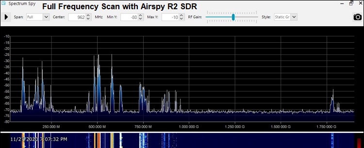

That is correct. The last three images were:
1. RTL-SDR.COM V3 dongle with free open-source Scanner software from GitHub
2. SDRplay RSP1A SDR with SDRuno software
3. Airspy R2 SDR with Spectrum Spy software that is included with the SDR# (SDRsharp) software download
When comparing the SDRplay and the Airspy,
noticed the noise spectrum on the lower frequency side of Channel 3 is different for each.
Specifically, the noise is increasing near lower edge of Ch3 for the SDRplay,
for the Airspy decreases a bit near lower edge of Ch 3.
Yes; three factors account for that:
1. The noise floor is not constant on VHF, especially VHF-Low; the scans were done at different times
2. The RSP1A with the SDRuno software is limited to a useful bandwidth of about 8 MHz; each side falls off pretty fast. The Airspy R2 with the Spectrum Spy software has an extremely wide bandwidth for a scan only limited to the full bandwidth of the R2.
3. The bandwidth of the antenna

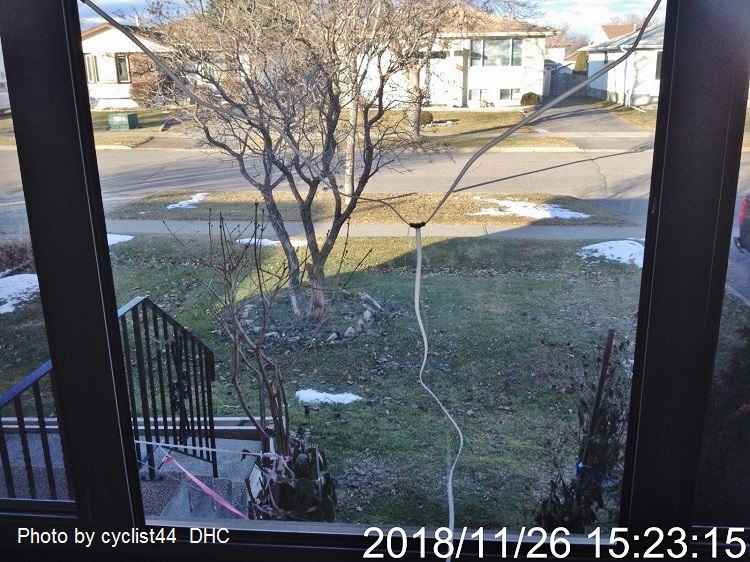

I don't actually have an RF channel 3 in this area, or any 2-6 channel. That is why I bought the Thor modulator to simulate an RF 3 ATSC channel. I have been studying the affect that a high noise level has on the reception of VHF-Low channels.
I first became interested in that project while trying to help a Canadian receive RF 2 and 4. I thought a CH3 folded dipole had a chance of receiving both. He was having no luck using an FM folded dipole of twinlead with 30 gauge conductors. I encouraged him to make a CH3 FD with larger diameter conductors, but he seemed unwilling to do it. I suspected that he had sufficient signal strength, but a high noise level. He was able to receive 9 OK.
I have two CH3 folded dipoles. I have one connected to the output of the Thor modulator. The other is connected to my SDR or a TV. It picks up the CH3 ATSC signal from the Thor modulator as if it were an OTA signal AND the ambient noise. This tells me how much stronger a VHF-Low signal needs to be for a sufficient SNR above the ambient noise.
