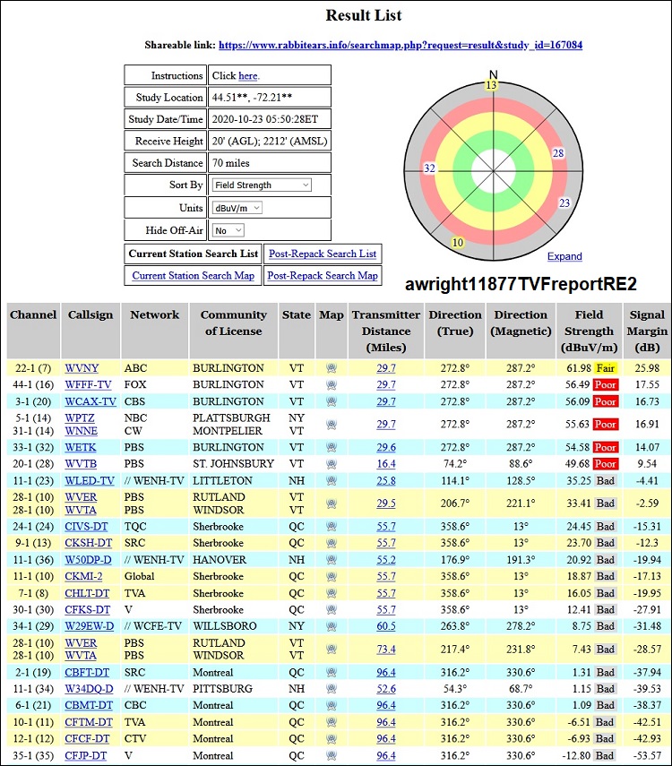

RabbitEars.Info signal map query:
https://www.rabbitears.info/searchma...tudy_id=167084
TVFool TV Signal Analysis Results:
http://www.tvfool.com/?option=com_wr...9038b5adb100a4
For reference, I can receive WCAX, WPTZ, WVNY, WFFF, WETK, WNNE (now on Mt. Mansfield with the other Burlington/Plattsburgh stations) and the WLED-TV NHPTV repeater out of Littleton, NH on ch 11.

Hello, awright11877; welcome to the forum.
Thank you for the reports and details.
I agree with jrgagne99; Sherbrooke will be very difficult and Montreal would be not likely.

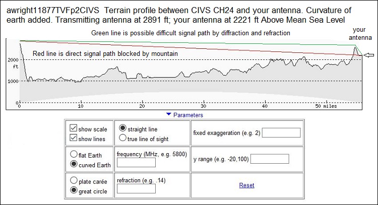

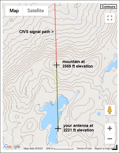

Although Sherbrooke is only 56 miles away, there is a mountain in the signal path that is close to your location.
using different profile software:

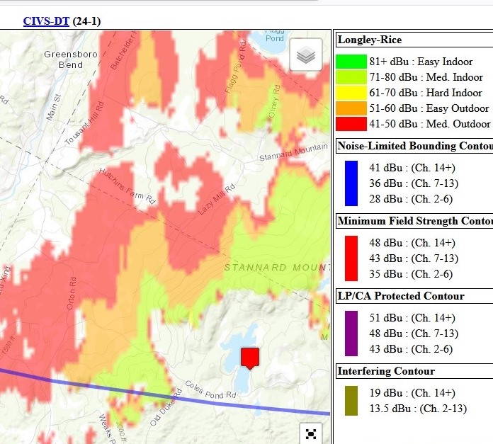

the coverage map shows no color in your area:
