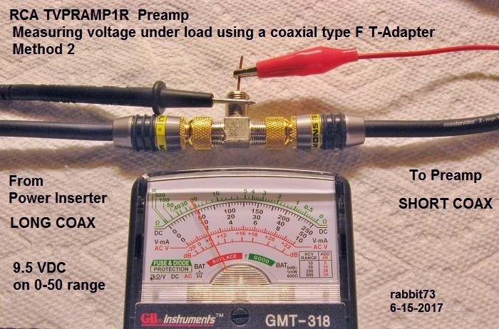

To check the RCA, you have to make some voltage measurements.
First you check the voltage coming out of the power inserter without the preamp connected:
Next, you check the voltage at the upper end of the coax without the preamp connected:
Then you check the voltage to the preamp with the preamp connected. This is a little more difficult, because you need access to the coax center conductor when the preamp is connected. I use a T-adapter:

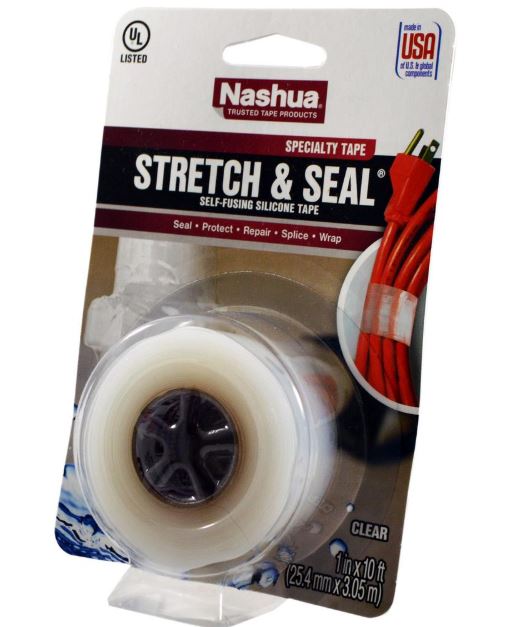

I’d suggest “stretch and seal” or similar tape. It sticks to itself and water can’t get in.
Duct tape can be porous.
I'll second that suggestion. Electrical tape and duct tape are absolutely useless to seal antenna and coax connections. The self-fusing silicone tape is great and will keeps connections clean and dry for years. One commonly found brand is Nashua Stretch & Seal. You can usually find it at your local orange big box home improvement store.
