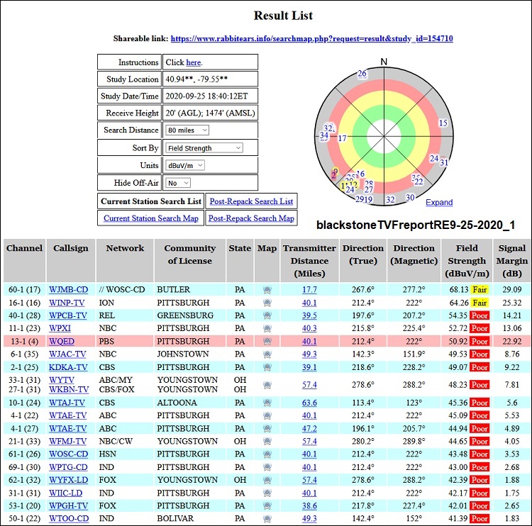

Here is a current report for blackstone, unless he has moved:
https://www.rabbitears.info/searchma...tudy_id=154710
I prefer to use coordinates for a rabbitears.info report. I use Google to give me the coordinates, enter them in the box, and press Go. That way, I don't have to mess with the pushpin.
You can enter both coordinates in the left box separated by a comma, or enter the lat in the left box and the long in the right box.

Thanks, Rabbit.
Rabbit Ears is tricky
I did enter my address and even saw all my stations.
Sorry about that.
Were you able to receive WTAE when they were on real channel 51? Were you ever able to receive WTAE after they transitioned to real channel 27?
I was able to receive WTAE until a couple weeks ago.
It was never one of my better stations
Now it's very pixelated and is watchable very infrequently.
I'm an old fart so I need my son to climb for me.
He's off weekends but, unfortunately, I'm on 48 hour work/on call this and next weekend.
Like to get WTAE because that's where the best college football games are
WTAE was problematic awhile ago when I started this original thread but pretty reliable until recently

Well, after seeing that RabbitEars report, I will just have to comment that I think it is remarkable that you are receiving the stations you are getting now. If any of your coax connections are a problem, hopefully replacing them will eliminate enough loss so you get your ABC affiliate again. Let us know what you find when you're able to get someone up to the antenna.

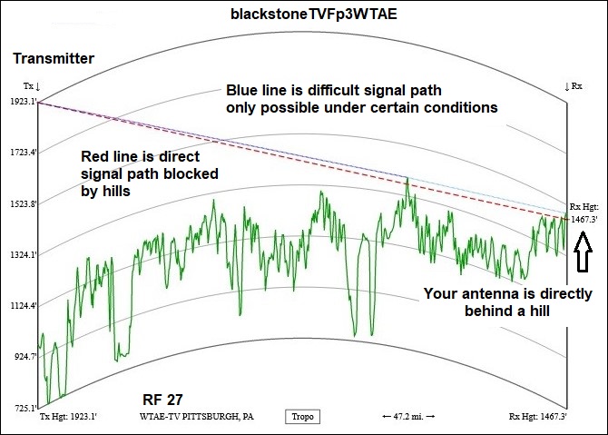

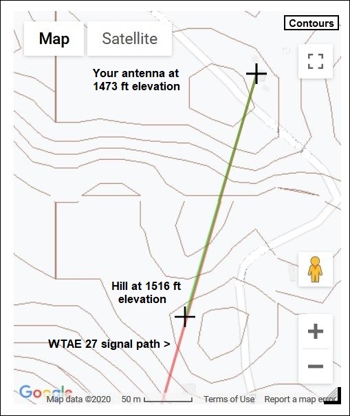

Yes, it is; you have to do it just right.
WTAE is listed as a Tropo channel. Atmospheric changes will affect the signal.
I know what that feels like; I'm 87.
WTAE will always be difficult for you because there is a hill in the signal path. You would need an expensive tower to get your antenna high enough.
Your location is in a dead zone (no color).
