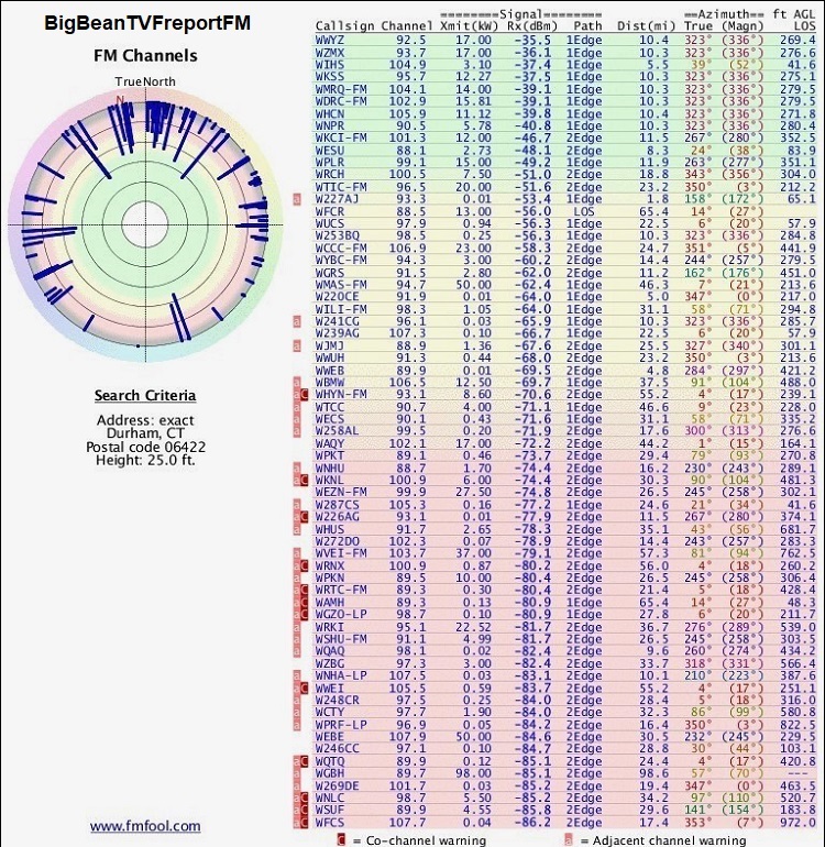

Thanks for the FM report image. I see you found out that the FM reports don't link like the TVFool reports. There is a way to do it, but it is complicated.
Which low power stations, by callsign, are you interested in receiving?

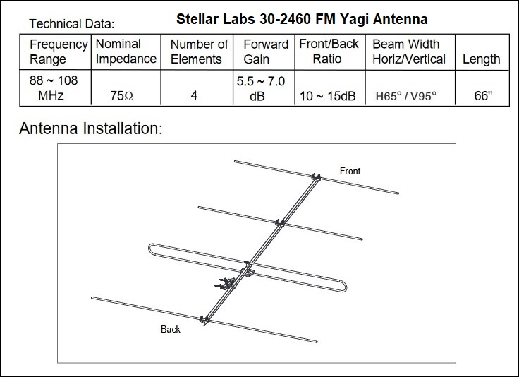

FM Yagi antennas are getting hard to find. Newark has the Stellar Labs 30-2460:
https://www.newark.com/stellar-labs/...nt/dp/97W3565#
Six feet away is OK, unless the UHF antenna is in front of the FM antenna.

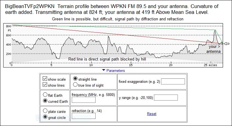

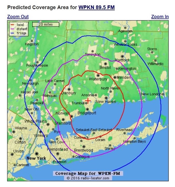

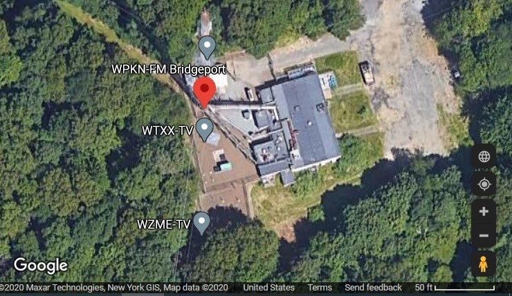

This is what the WPKN-FM transmitter site looks like:
This is the coverage area for WPKN:

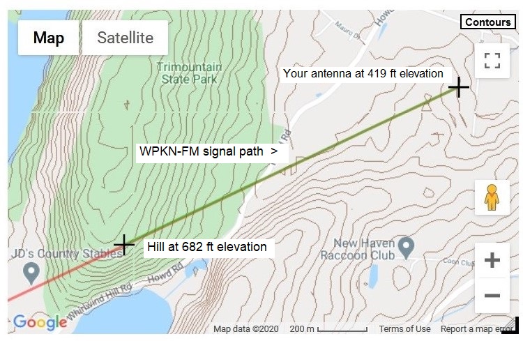

That ridge to the west is a good chunk of the problem.
Very true; it blocks the direct signal:

WOW Thanks, Rabbit! Is that Google Earth? I haven't used it in awhile.
Yeah, that looks like the SECOND ridge, as we're in a little valley. There's
a hill across the street to the West, then beyond TriMountain that higher
ridge. I've heard folks who live atop it can receive NYC and I believe it.
