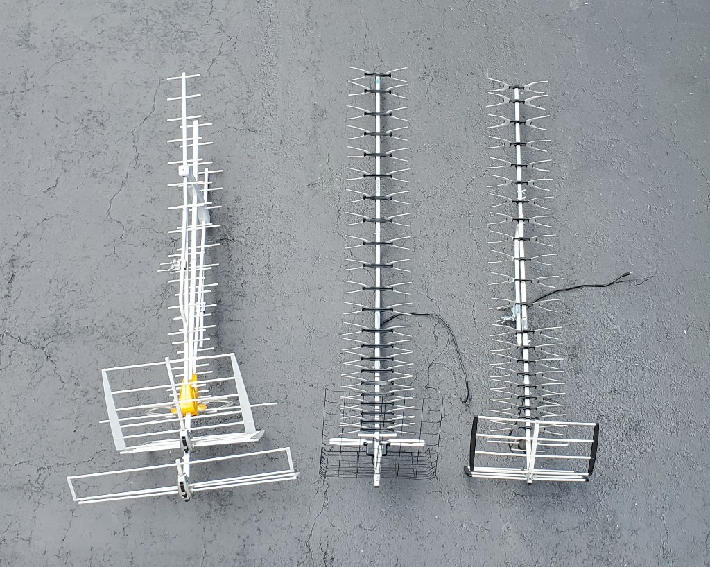

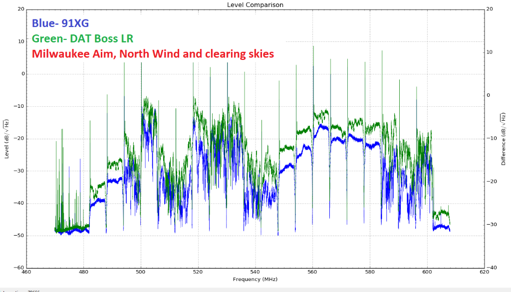

I have also had very good results with my pair of Televes DAT Boss antennas. I reviewed it on some other sites.
I recently had a shootout between the Antennas Direct 91XG, the XTreme Signal HDB91X and the Televes DAT BOSS LR Mix.
I'll try to bring it over here although this forum has not been the friendliest for me to work with.
I can post my results later if there's some interest. Let's see what happens...

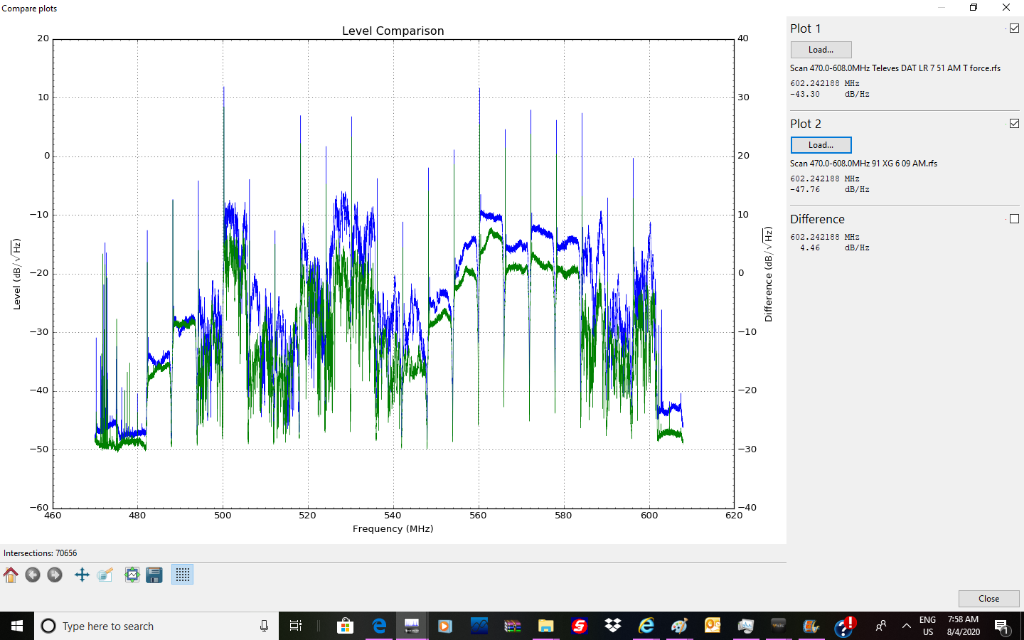

I'm not here to argue with you but I wanted to at least tell you, I've had a pretty darn good results with the DAT BOSS LR Mix.
I found it to be a very good antenna. I tested it against the 91XG & HDB91X. I used the Kitz KT-200 which in my mind is the very best stand alone pre-amp available. Very close to the Televes max output.
I was impressed with the results. Don't get me wrong, those two other antennas are the best of the rest for UHF. I also did not test the VHF High simply because UHF was my goal..
