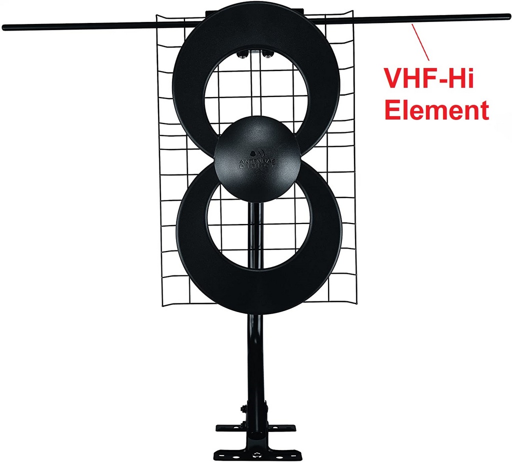

Well, to start with, the antenna you have is designed for UHF channels only. WAFB and WBRZ are VHF-Hi channels. You need a separate element for the antenna to pick up VHF-Hi. See the picture.
You can order a kit to add that to your antenna.
https://www.amazon.com/Antennas-Dire...CMG/ref=sr_1_3
There are other things, too, that could be the problem, but the first step would be to have the correct antenna.

Yes, tuners vary. Your signal level may be right at the border line--just barely enough for the good tuner and not good enough for the poor tuner. Hopefully adding the VHF element will garner enough signal improvement to make things work for you.

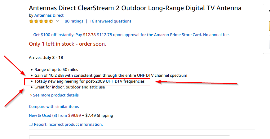

The product listing explicitly states what it is designed for.

Granted. But, not knowing any better, one might assume all DTV broadcasts are UHF.
The ad does not state that you can get an add-on device to expand the range to VHF.
Also, still not sure how to tell if a channel is UHF or VHF, what frequency range, etc.
