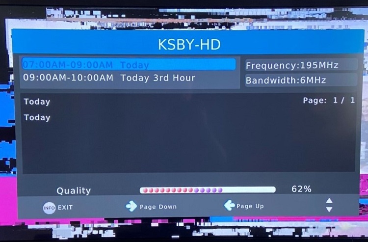

My Issues: RF CH 10 channels sometimes comes in fine randomly throughout the day. All of a sudden it will pixelate, freeze and lose signal altogether. My LG TV (2011 model) says “scrambled” or “No signal”. I tried an aftermarket tuner which shows signal strength. The signal was about 60% and the picture still pixelated or drops out, (see uploaded pic). I currently have a second indoor antenna installed and connected to a TV in the master bedroom (Samsung 2019 model). It has the same issues at exactly the same time. The Samsung TV is connected to an Antennas Direct ClearStream 1 Max

Each of the antennas performed about the same. And my indoor antenna does the same as the outdoor. I'm thinking my issues my be outside of my control? Does anyone have any thoughts? My next step is to try and call the station directly and see if an engineer can assist.
