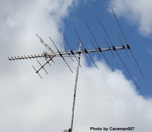

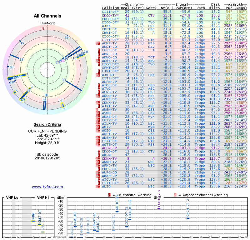

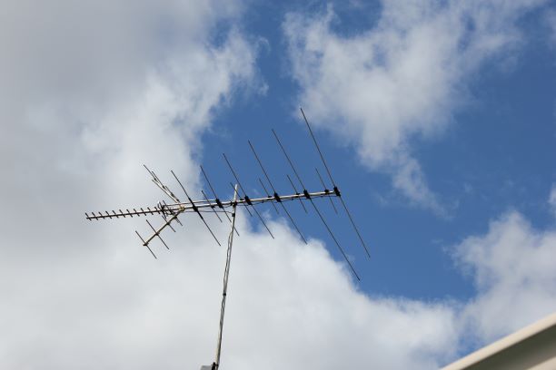

Hi all I am having problems with reception. I do not know if I need a new antenna and amplifier
( I think the antenna I have is like an RCA 3036 with a few less vhf reflectors ) . I'm having some channels fade in and out a lot.
My antenna is about 30 ft up with a radioshack UHF/VHF/FM amplifier model 15-1109. The coax is rg6 about 100 ft. This goes to a 4 way splitter there is 4 tv,s with 2 runs of about 30 ft one 40 ft and one 10 ft.
there are trees in neighbor's yard which probably doesnt help but I cannot move the tower to a different location. I will try to attache a couple of pictures and tvfool report. sorry cannot upload picture of antenna.
Thanks all
P.S. Could someone suggest the optimal direction for pointing my antenna. Please
What channels are important to you?
What channels are giving you trouble?
As long as the trees stay in the signal path, they will cause reception problems. Trees block TV signals.
Your antenna is very directional, so it must be aimed at the channels you want to receive.
Your preamp is very old; if it's still working don't replace it yet.
You can try replacing the 4-way splitter with a Channel Master CM-3414 distribution amp.
