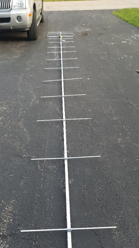

After disappointing results adding four elements on to the existing factory antenna (Mod 1), I figured it was time to go for broke. I was already geared up to go further anyhow.
Mod 2. I sacrificed one of the reflectors from one the donor antennas and cut 4 new directors to continue the pattern. So, the last 6 directors are all 21" and spaced 10.5" Without any specific antenna modeling it seemed like like a logical step.
I sleeved the inside of the boom with "U" (technically C-Channel) and laid it on the 3/4" under support which I had left extended on the first mod, I figure it would come in hand and it did. I also fabricated a tab so I could attach the upper support cable to the end. The cable is pulled fairly tight. It is fairly solid and withstood 45 mile an hour winds already.
I wanted to put the boom attachment clamp closer to the center of the antenna but my reinforcements don't allow for that. I'll have to research adjustable beam clamps or, of course fabricate my own.
Testing: So-so results. After several comparative tests, I believe these will be the most consistent results. Maximum delta measured was + 2.84 dB. Overall, it's more like 1.2 dB and at the very end the two patterns seem to blend. RF12 is not in the antenna aim market, it is being picked up from the back of the antenna.

Not specifically RF 8 that I'm after, it's just a transmitter I am using to measure my results. One reason is it is at least 49 miles away and makes it a far enough target. I could turn the antenna around and check RF12 also, but for now I like RF 8 because soon trees will leaf out in the path of RF12 and would destroy my baselines. I will test RF 12 soon enough though. before the leaves!
I don't know how to use the modeling software, I hear it is extremely tedious. I'm willing to learn it but I may have to do it later. I am hoping to find that someone has already tried this. I sent Holl_ands a PM but no reply. He has done the modeling but no mods so far that I know of.
What you did say was the director should begin to taper down and the spacing should widen. That is also of interest to me.
I did go to the link you sent, The picture show something similar to mine actually with some broken elements. The calculator is there, and although I can change the # of elements, parasitic elements and diameter of the boom, I click on "Show me the details" The boom should be 7.29 meters ! 14.20dB of gain. Nice.
Can I choose the length of boom I want? And then build it from there?
Some other questions.
What is an isolated Element?
Reflector? What to do with that?
Would I change my Dipole dimensions?
BTW, 26' 7" for a 17 element at 183 MHz whoa!

The answer to your questions is below in blue. I have only built one Yagi for TV and that was years ago and it worked very well pulling in a weak station (before the days of digital TV). I have used several for VHF and UHF ham radio bands.
It is calculating the minimum length of the boom to match the number of elements you specify. Try changing the number of elements until you reach a point that will fit on the boom length you have available.
It is asking are the elements directly connected to the boom (metal to metal) or are the elements insulated from the boom (isolated)
The reflector is the element mounted behind the driven element, in your case you have four reflectors mounted on a vertical boom at the rear of your antenna. The calculated reflector length would be a good starting point for each of your reflector elements. You could probably even replace the reflector assembly you have now with just one reflector element.
Most likely you might need to. Your driven element is a folded dipole configuration because it provides an impedence of about 300 ohms, which works very well when using a 4:1 balun. There is another calculator you can use for that: https://www.changpuak.ch/electronics/Dipole_folded.php
Keep in mind that a Yagi antenna has a bandwidth of 2 to 3 percent of its design frequency, so a Yagi designed for 183 MHz will only cover enough frequency range for 1 TV channel. They are great and high gain but only when you are looking for one specific channel.

Tim, Tripleo, I'm going to call this MOD 4, here's what I went with, from Tom Ballister:

VHF super-long yagi
I have seen a number of antennas constructed in that manner. I doubt that it makes any substantial difference.
Triple O and Tim and whoever else is following this with interest. We had the best weather yesterday after the storms went through. However it wasn't the end of the rains but I had a full three or four hour window to get my 18' long yagi braced up with a over the boom support. I cut the 1in by 1in support down to about 12 and a half feet and riveted upright flat stock braces:
I want to say thanks to you guys so far for keeping the interest this project.
I haven't put it in the air yet, probably this weekend.
File Type: jpg 20200514_224844_resized_copy_600x915.jpg (285.4 KB, 3186 views)
