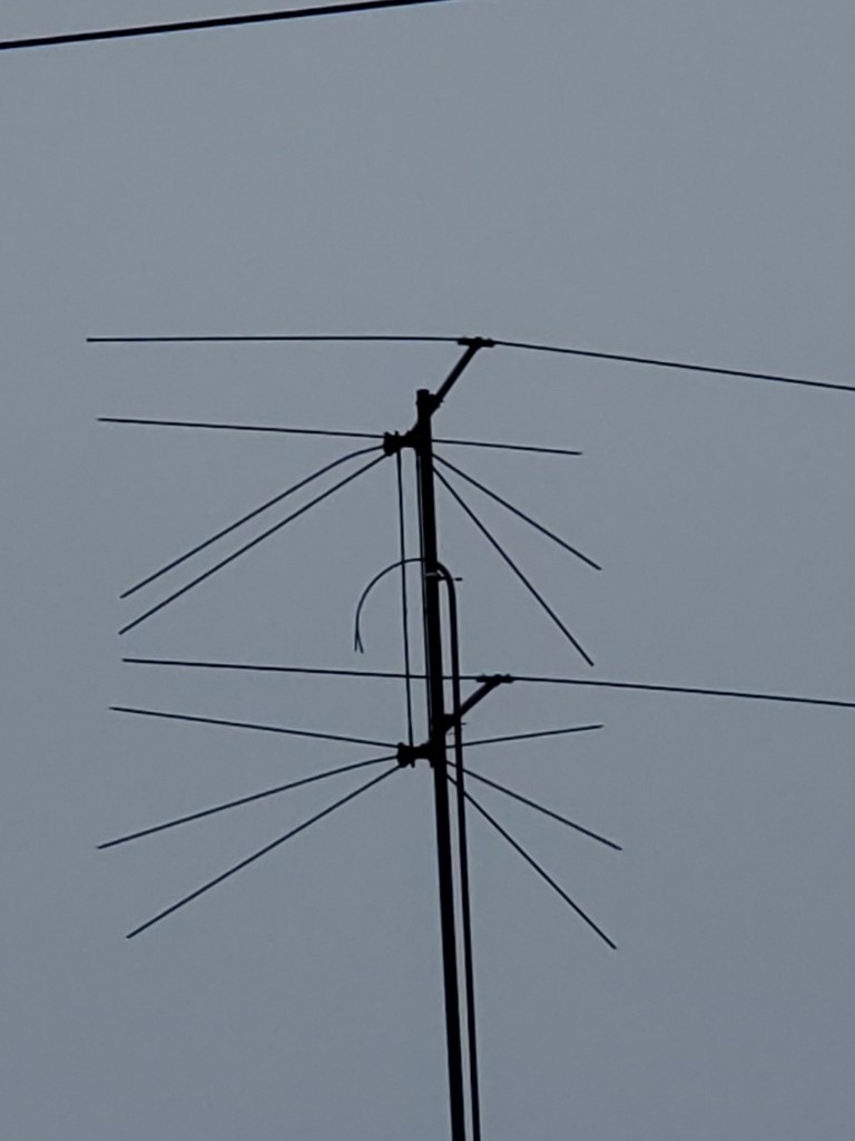

I've never seen this in Kenosha in fact it's the only one I've ever seen.
Is it even a TV antenna?

Conical Yagis
...Is it even a TV antenna?
Yes.
It is a stacked pair of conical Yagis. Very popular TV antenna in the 1950-1970 time range.
The Conical Yagi covers both high and low VHF channels with moderate gain.
The conical driven element is quite broad band. Before log periodic antennas
were invented, the conical driven element was frequently used to obtain enough
bandwidth to cover the frequency range of VHF channels.

Thanks Tripelo!
So it is a TV antenna. Back in the days before UHF? It's very cool looking antenna. Unfortunately, It looks as if it hasn't functioned in years.

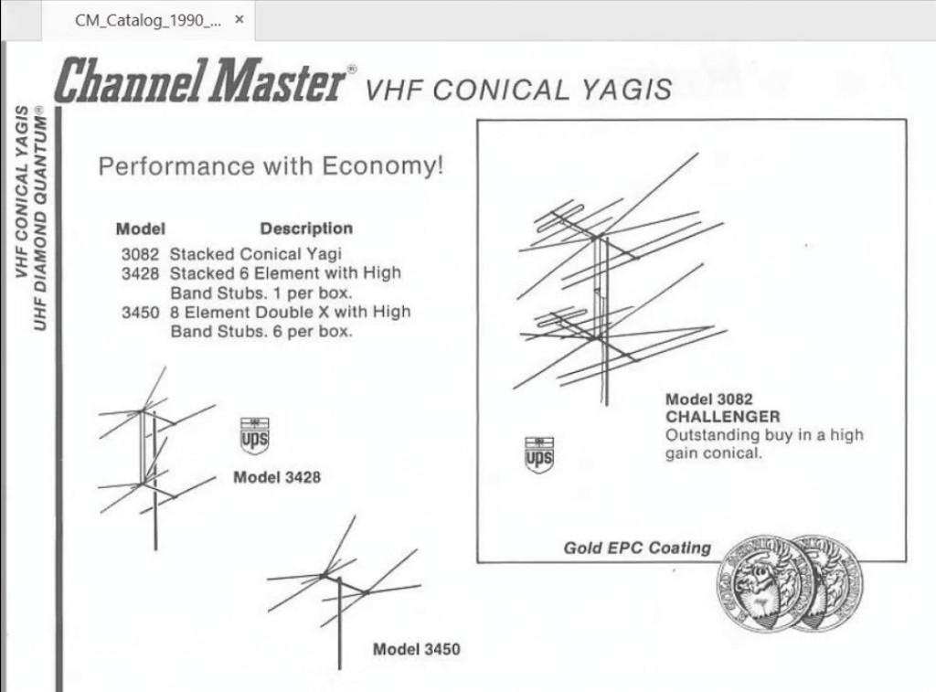

Still available in 1990 ?
Hard to believe this antenna was still in the 1990 Channel Master catalogue
At least that's what the tab shows. Catalog page courtesy of Rabbit 73.
