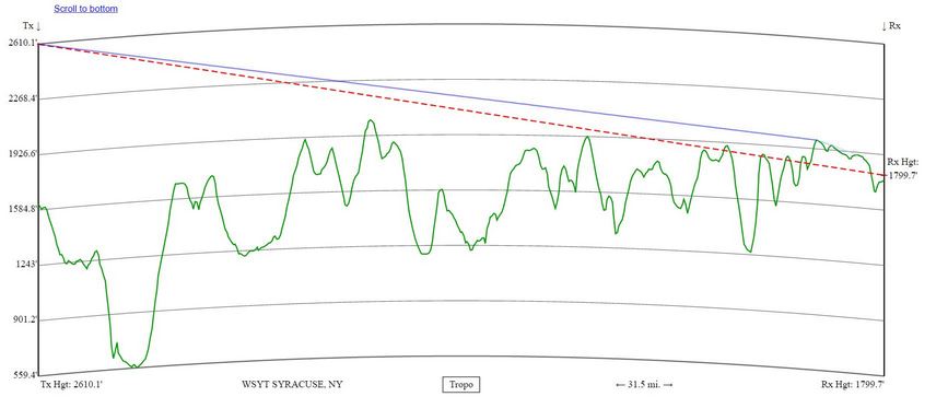

Yeah, your location shows you are behind some pretty good size hills...that will definitely cut down on the TV signal available. On your RabbitEars report you can click on the 'Transmitter Distance (Miles)' figure for each station and see what the terrain looks like between you and the transmitter. Here is an example for WSYT in Syracuse.

yikes, some of the ones from Utica are serious line of site impared.........!
