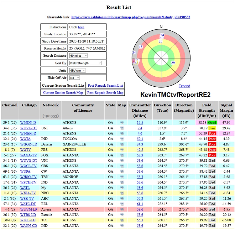

Before we can even begin to help you, we would need to see a signal report for your location. East of Atlanta isn't much help and your original TVFool signal reports are no longer on the TVFool server. Please do a rabbitears.info signal report. You can do it here:

Thank you for the reply. The AVS Forum link was helpful...the most recent post there indicates that the only WSB signal right now is the one from Atlanta.
That seems to be reflected in the RabbitEars report also. The only WSB transmitter showing up is channel 32 from Atlanta. Meanwhile, two of the three channels that should be by far the strongest are listed as off-air.
https://www.rabbitears.info/searchma...tudy_id=190553
I see that the database for the TVFool reports was last updated pre-repacking...that's actually quite helpful for comparison if it's still accurate as of how things stood in 2017.

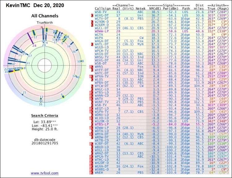

(Running it again for my location produced this report:
https://www.tvfool.com/modeling/?id=903872156194f3
Back then I was able to pick up the likes of WANN-CD and WTBS-LD on a good day...haven't yet had a sniff of them since I got set up with my new preamp.)
Thank you for the two signal signal reports. You are much further east than I thought you were, so your signals are quite weak. The signal margin of -11.26 dB for WSB in the RabbitEars report is similar to a NM of the same value in a TVFool report.

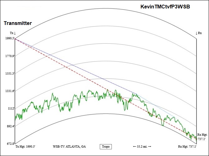

Terrain profile for WSB using different software:
Any trees in the signal path will make reception of WSB even more difficult.
