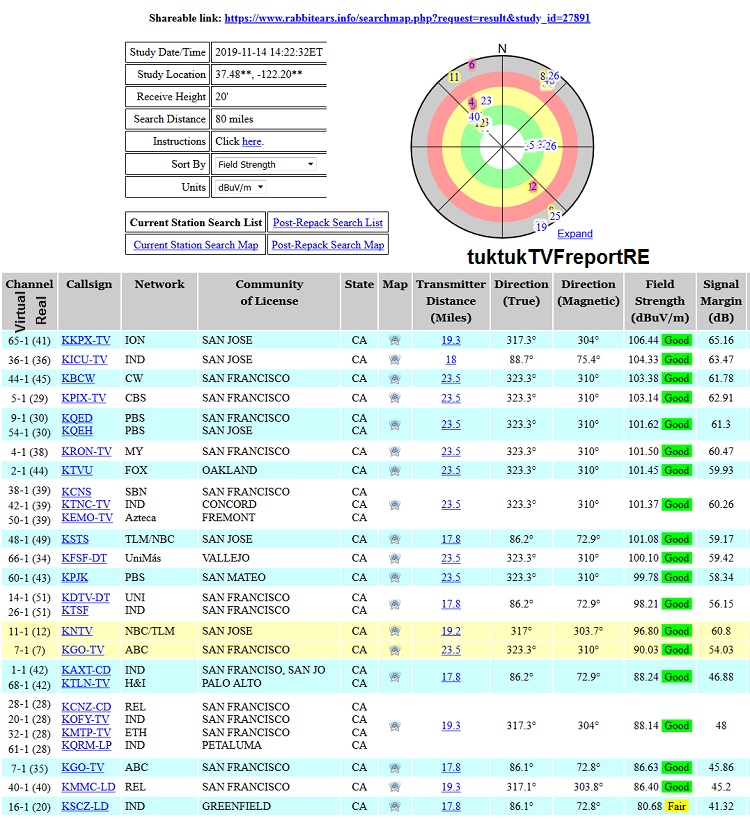

This is an image of your TVFool report:

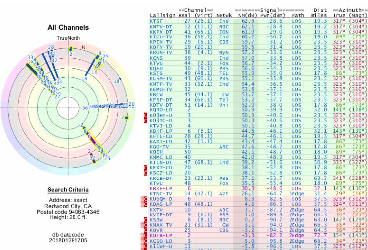

For comparison, this is a signal report from rabbitearsinfo for your location:
https://www.rabbitears.info/searchma...study_id=27891
This is an extract from that report:
Any recommendation on one of the above, or for that matter best antenna for me? I all be installing on the edge of the roof, which is about 17 ft or so, I can add a pole for extra 2-3 ft, so close to 20-22 feet.
I think you should stick with just the channels from San Francisco which has Fox.
Your channels are strong enough so that you should be receiving it OK. Perhaps the trees are in the signal path from San Francisco. Try moving the antenna to slightly different locations before making any permanent mounting.
If your present antenna doesn't have enough gain on VHF-High for KNTV NBC on 12 and KGO ABC on 7, try a Winegard HD7694P antenna.
If you look at your rabbitears.info report in the link, you will see a column on the right called Repack Info; I cut it off the image above. It shows you the Repack Phases when the channels will be changing in the near future, which will require you to rescan.
