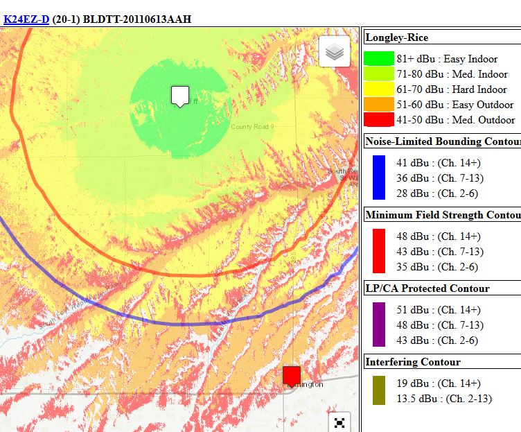

Hello, ohazco. Thank you for the reports.
It sounds like the new tower location isn't quite as good as the chimney location was for reception.
I have not received Denver channels reliably (>20% of the time) for about the last year and have just had it pointed east.
You are not receiving channels from Denver, you are receiving channels from low power translators in Idalia that carry Denver channels.
Denver channels would never make it to your location except during unusual atmospheric conditions.
Something might be in the signal path from Idalia that wasn't there before, like trees.
Channel 10 has started to get choppy.
Channel 10 is a VHF channel; the 91XG isn't designed to receive VHF channels and its balun doesn't pass VHF channels.
This weekend I decided to try a new 91XG and a Winegard Boost XT preamp (instead of the RCA) and completely rewired, to try to get my Denver channel back. I think it got worse.
You are on the extreme fringe outside the area of coverage for Idalia channels. The red marker is your location.
K24EZ is a low power translator only running 0.192 kW ERP, that's 192 Watts. The actual transmitter output is only 20 Watts with an antenna gain of 8.06 dB.
0.03 kW TPO + 8.06 dB gain = 0.192 kW ERP
https://www.rabbitears.info/tvq.php?...ms&facid=55618

Small changes in location can make a big difference in reception.

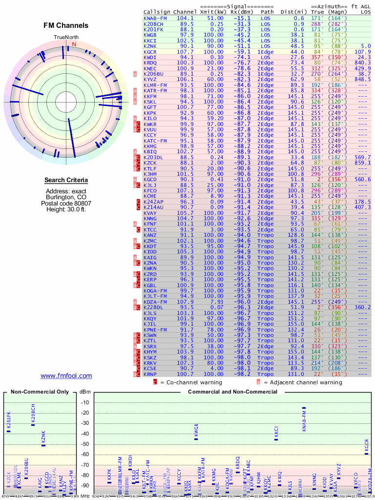

Rabbit, attached is my FM fool report.

Thank you for the FM report. I see one strong FM transmitter KNAB coming from the south with a signal power of -15.1 dBm. If your antenna is aimed north or east, that will reduce the possibility of FM interference. If you do have FM interference it is most likely to be on VHF channels and a filter would help.
