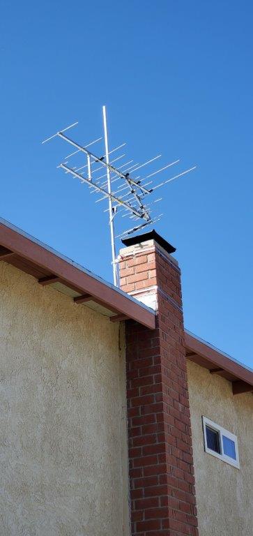

Wellp, got my antenna mounted and grounded. Got 159 channels that included all major network with strong signal.
droidy is offline   Reply With Quote
Old 21-Sep-2019, 5:51 PM   #12
droidy
Join Date: Aug 2019
Posts: 8
Here are the pics.

Your antenna set up looks like a professional job!
I'm in a strong signal location here in SOCAL LA/OC and get between 168-178 channels on a clear day. So, 159 at your location droidy is remarkable. Outstanding work beating the odds. Virtual slap on the back from me!
Thanks so much for reporting your findings and posting the pics.
As Hannibal Smith on the 80's TV hit show, "The A-Team" used to say, "I love it when a plan comes together!"
All the best, droidy! And enjoy all the free TV programs we get here in the Southland.....
