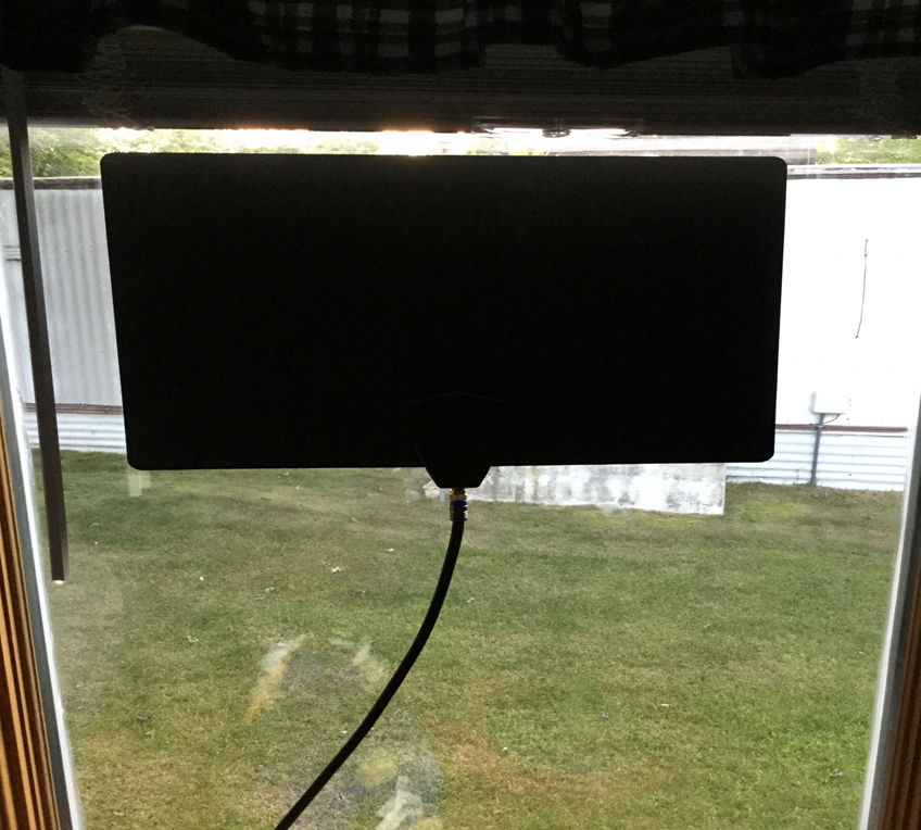

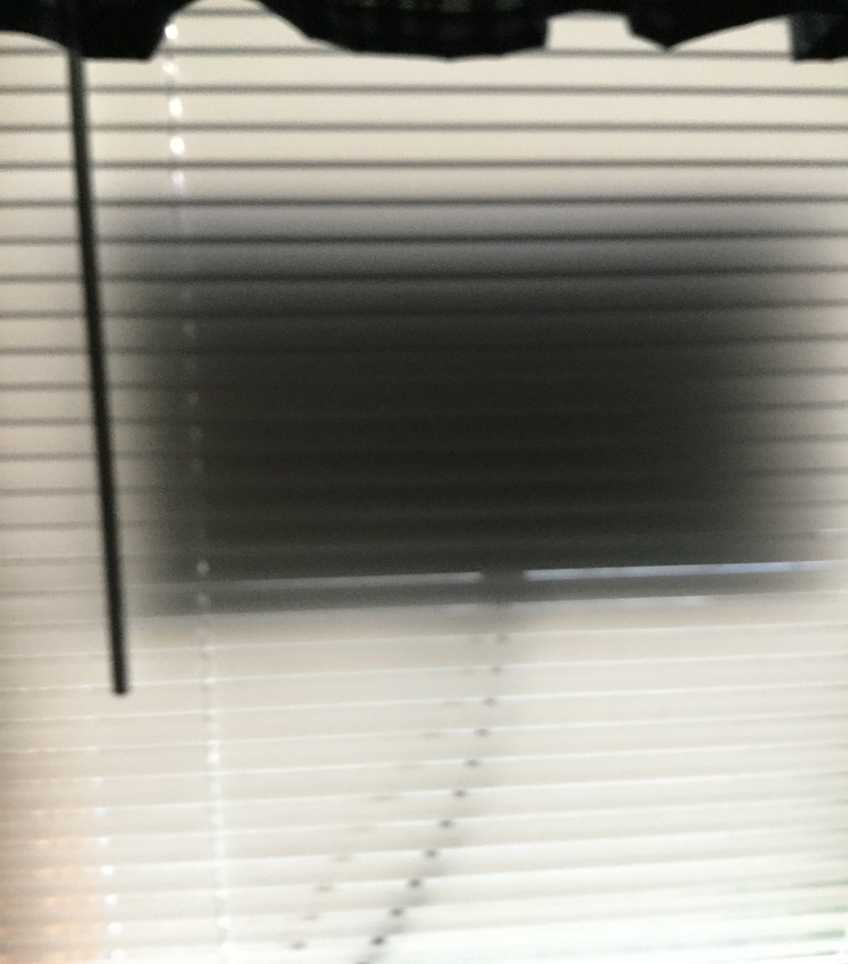

Got a couple of questions. I going to include pics. What type of coaxial cable do i have. Can't make it out. Also is that the right place for it. on the window and is the shades ok or will it cause problems. I need the shades down at night.

If the shades are plastic they will have no significant effect on the antenna performance. If they are metallic they will have quite a bit of effect which will be frequency dependent. If the distance between the antenna and metal shade is just right, you may actually get a small boost in directional gain. If the spacing is too close or too far, you would expect reduced antenna performance.
The coax may be RG6 but I can't be certain.

The shades are plastic from what i can tell. Thank you for the reply.

The Flex comes with a 3' RG6 coax that is to go between the antenna and the included inline amp as well as a 12' RG59 to go from the amp to the TV (or wherever).

I'm not using the coax cable that came with the flex. I'm using the one i had before. i believe it 50 Ft Coax Cable that i bought at walmart a while ago.

I would either use what came with your Flex, or replace it with a short RG6 jumper, say 15' or so. That way you minimize interference and maximize reception for your TV frequencies.

Just wanted to give you guys a head up. The Sure Grip that came with the flex i had to take off. As it was wearing out. So i put some masking tape on the flex and window and that work out great for me. Also all channels still come in clear in morning, afternoon and evening. I also replace my 50 feet cable with a 15 feet cable. the 50 feet one was rg6. I got a 15 feet rg6 onn one. It working so far.
