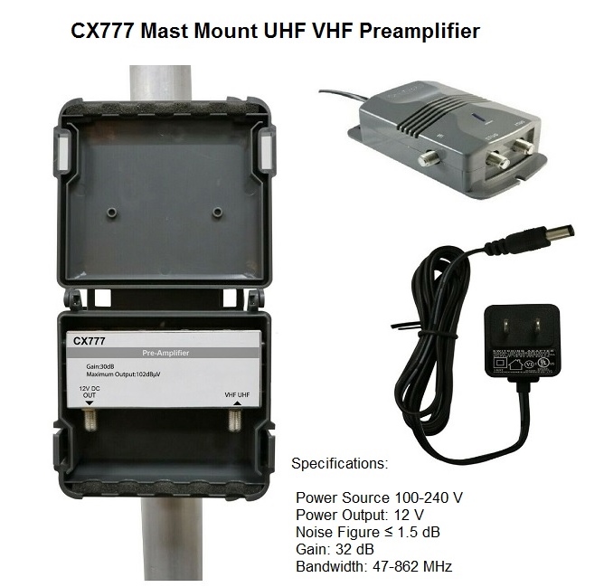

or the CX-7778
That is the CX777 sold by electorica on eBay. They have changed the model number in the description to make it similar to the Channel Master CM-7778, which it isn't.
Specifications:
Power Source 100-240 V
Power Output: 12 V
Noise Figure ≤ 1.5 dB
Gain: 32 dB (says 30 dB in the image)
Bandwidth: 47-862 MHz
I doubt that the Noise Figure is as low as 1.5 dB. A Gain of 32 dB is too much; very easily overload as Channel Master found out to their dismay with their redesign of the CM-7777 with a single antenna input and a gain of 30 dB.

So if the 777 (7778) is out, then maybe try the Hamza? I did like that it had a metal (shielded) housing.
I also see a half dozen "no name" amps on ebay ... is one better than another? Can any be trusted?
