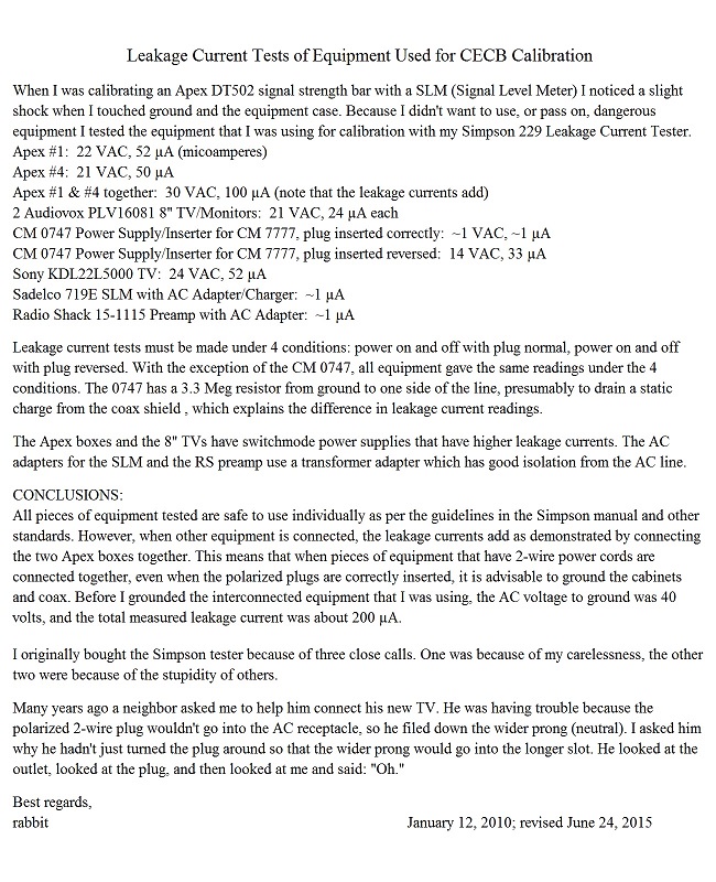

As a temporary (only) measure, I have connected the coax shield to the house ground using a spare 3-wire plug. Of course, the outlet must be a properly wired 3-wire receptacle. Using the plug avoids messing with the receptacle wiring.
I have had three close calls with electrical shock, so I think it is a good idea to connect the coax shield to the house electrical system ground, even for an indoor antenna.
The antenna coax is connected to AC operated equipment. All AC operated equipment has leakage current, even when operating properly. We can't feel it because it is below our level of perception. If the equipment has a 3-wire cord and is connected to a properly wired 3-wire receptacle, any leakage current will be shunted to ground.
If the equipment has a 2-wire power cord, any leakage current will go through you to ground. If there is a defect in the equipment, grounding the coax will protect you from shock.
When I was calibrating two converter boxes, I felt a tingle when I touched the coax shield and a grounded metal strip on the counter. The antenna system had not been grounded for the tests.
I wanted to find out why I was being shocked, so I made some measurements with my Simpson 229 Leakage Current Tester. The meter showed almost 200 µA (200 microamperes or 0.2 mA) of leakage current.
When I grounded the coax with the plug shown above, the leakage current went to zero.
Details of tests in attachment.
