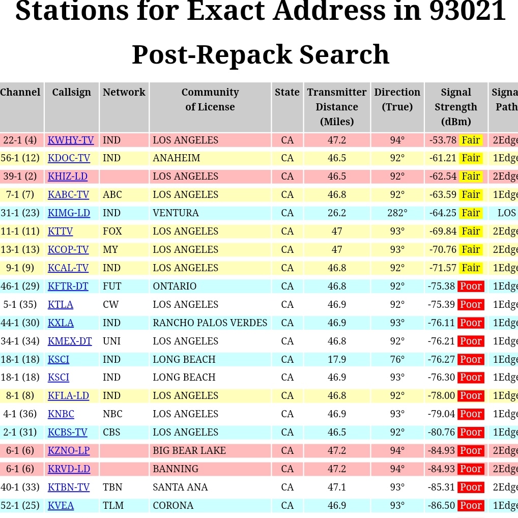

Thanks for the replies. I re-ran my address through rabbit ears and it's not nearly as good as the center of my zip code. See attached screenshot....
By the way, does it look like I need VHF if I only wanted major networks?

Zip codes usually cover larger areas than an exact address. You did the right thing to narrow down your reception quality.
JoeAZ knows your area and he's another experienced Tech on this forum. I would go with his recommendations too.

If you opted for VHF only, you would likely get the ABC, FOX and MY affiliates. KNBC and KCBS would be unavailable though.
