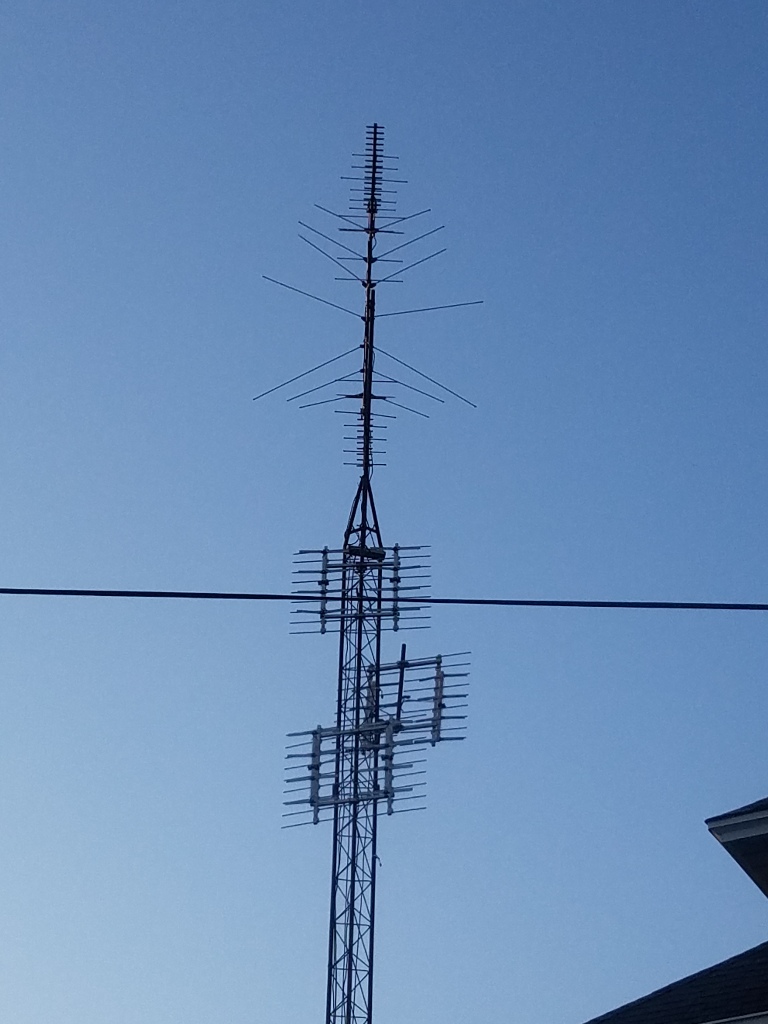

Antenna Spotting in Kenosha #3
Here's another one, apparently the guy is trying to get signals from North and South. I wonder if he still uses it seeing how he has the 8 Bays underneath them?
Can anybody ID that antenna? Or is it Home made?

It looks like the old 4* bay antannacaraft. Uhf tv antennas

It looks to me like two CM 3016 lashed onto a common book.

No way I think it's a Winegrud 4bay ok channel master one of the best ANTENNA manufactures that used a ham Radio guy to design ota box with IT'S ATSC performances

What a waste of a nice TOWER.

That top antenna would almost certainly be two antenna's
modified into one. I imagine it is NOT very efficient or
effective receiving signals 180 degrees apart. i have come
up with a much better alternative to receive UHF signals
180 degrees apart. It is much more efficient than removing
the reflector.

It does look like a custom mod.
I imagine it is NOT very efficient or effective receiving signals 180 degrees apart.
It looks like it would perform about as well as Bob's present system.

I think his antennas are to close together!!!

Hi Joe, I have to agree with you it looks like they cut two RadioShack VU160 antennas in half, joined them and called it an antenna.,Lol!
I'm not sure what they were doing, the construction looks old, it was probably done in the 60s or 70s. I just happened to catch it out of the corner of my eye do to my severe ADD. (Antenna Distraction Disorder)!
I've never seen so many different antennas in my life then in Kenosha which I have dubbed "antenna town". Also, lots of towers.
Okay, I give up what do you do to receive bi-directional without removing reflectors?

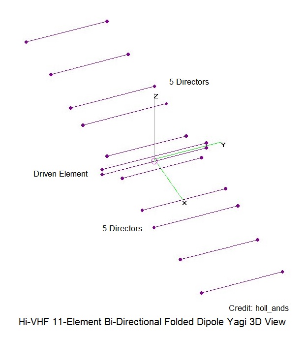

Okay Rabbit, have you ever seen two antennas put together like that?
The closest to that I've seen is a double-ended VHF-High Yagi. It has the driven element in the center and directors on each end, but no reflectors.
I can't find the poster's image right now, but holl_ands did model a similar antenna:
The two directions are combined in the antenna.
https://imageevent.com/holl_ands/bidirectionalyagis
https://imageevent.com/holl_ands/bid...ionalfdyagiopt
This antenna IS bi-directional; it has more gain than a bi-directional dipole, but less gain than the Stellar Labs 30-2475. It still has the potential problem of co-channel interference from the two directions.
