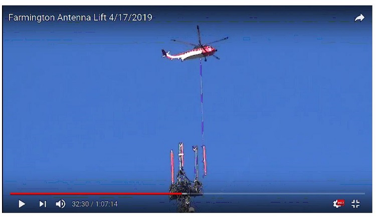

Old 22-Apr-2019, 8:09 PM   #7
For all those like me who want to see it for real:
https://www.youtube.com/watch?v=ZRNBQe_ZOm8
Neat!
Thank you.
How much RF exposure can the workers tolerate without harm?
Old 22-Apr-2019, 8:37 PM   #8
Tower Guy
Location: Delmar, NY
Posts: 1,236
Exposure to high RF fields causes warming of the body, just like being in a microwave oven. In this case the stations are operating at about 25% power in a temporary antenna that is 164’ lower on the tower. The workers are exposed to high RF as they climb past the temporary side-mount antenna. The side mount antenna is directional, with reduced power toward the elevator. There are five ways to stay safe; ride the elevator past the antenna quickly without stopping, equip the elevator with a faraday shield to reduce the signal inside the elevator, wear an RF suit that shields the body from the RF, ride up the rigging cable passing the antenna quickly, and/or temporarily lower the power of the transmitter.
Thank you for the details. I felt the warming when I was too close to my 14 MHz mobile antenna at 100W.
