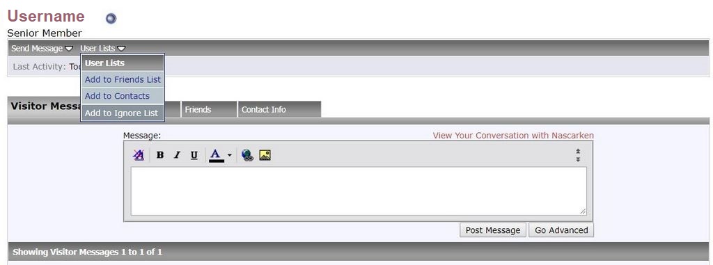

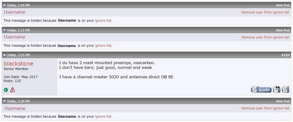

BobsGarage,
If there are group members whose posts you don't want to see, you can click on their Username, click on User Lists, click on Add to Ignore List.
From then on you will see that they posted something, but you won't see what they posted. It cleans up the threads nicely.
