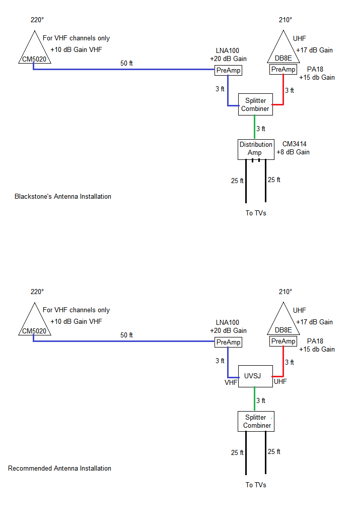

OK, great, thanks for answering all the questions. I think the best thing to do at this point is to obtain a UVSJ and rewire your system as I have shown on the bottom of the attached drawing. It will be real simple to do. You will be putting in the UVSJ where your combiner/splitter is currently located and replacing your distribution amp with the combiner/splitter (you can always put the distribution amp back in if you need to). You already have plenty of amplification with the preamps and the distribution amp might be overkill. I think the UVSJ has a good chance of resolving your problem.

I have revised the diagram to show the 4 port splitter.

Tim's revised diagram shows the UVSJ after the preamps, but it does not show the power inserter for the PA18 or how the LNA100 gets power.
I am not clear as to how Blackstone is powering his preamps. If he can explain that to us, I will add it to the diagram.

Referring to your original drawing, Tim.
The UHF antenna has the Antennas Direct PA 18 preamp on the mast.
The power inserter is before the splitter/combiner inside.
The VHF antenna is using the Winegard preamp.
Using Rabbit73's explanation above for the LNA 100, it is also on the antenna side of the splitter/combiner.
Hope this is the info you were looking for.
Thanks.

Blackstone, in an earlier post you said you had the PA18 mounted on the mast of the DB8E and then 3 ft of cable connecting the preamp to the splitter/combiner. You also said the splitter/combiner was in your basement. Can you confirm that the 3 ft of cable is correct? That just doesn't seem right to me.
Old 15-Apr-2019, 5:56 PM   #80
blackstone
Join Date: May 2017
Posts: 139
Sorry for any confusion.
The PA 18 is connected to the DB 8E with a 3' cable.
Then 50' cable is connected to the PA 18 to the power inserter with 3' cable to the combiner
