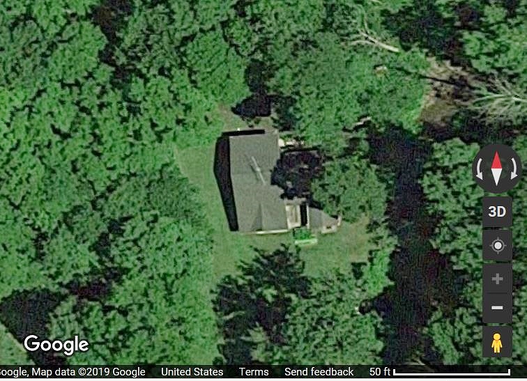

Originally Posted by Dagwood View Post
This is somewhat baffling. What are my options? I am more than happy to pay someone a fair price to troubleshoot and fix it.
The only way you are going to improve your reception is to put up a tower so that your antenna will be above the trees on your property.
