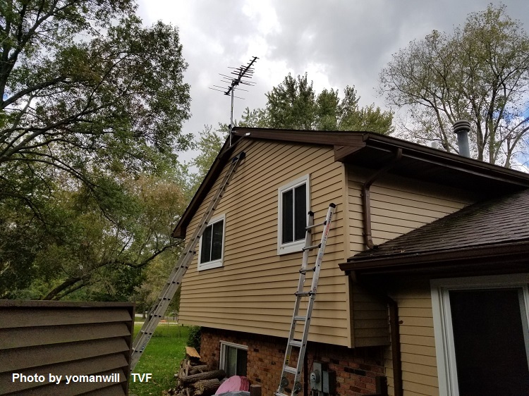

Welp no dice in the attic. Pulled in a number of channels, but between medium to weak. WJBK went out when the wind blew. Going to have to mount outside.
yomanwill is offline   Reply With Quote

You don't know till you try. We have a have trees surrounding us, most just on the lot lines. The oak wilt hasn't got them yet.
Will moving to a gable mount outside help OR should I do some fine tuning with the setup I have?
Now that the rain/wind has died down the signals are "medium", Samsung TV has a level bar hard to give a exact number.

Massive success. We had a nice bit of rain/wind come though WJBK dropped down 40%. Now that it has passed 100% signal. I'd say moving from the attic to open air easily made a 50% improvement.
https://imgur.com/a/H4umNkQ
Old 20-Oct-2018, 10:35 PM   #13
Thanks for the report of improved reception and the nice photo.
Good job!
