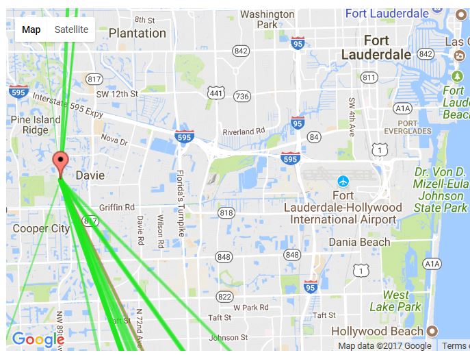

A map of your area showing your location and the airport to the east:

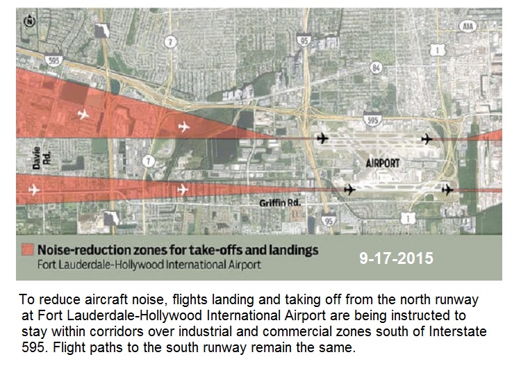

An old flight path map for noise reduction:

Thanks for that info. The south runway corridor is right over my house. They use that for general aviation but heavies use it also. The North corridor is over the golf course to the north of me. Maybe my problem is the north facing antenna is getting a signal from the towers to the south, and an echo from the aircraft to the north. I'll get it turned to the south and maybe the planes overhead won't interfere. The terrain is flat, no forest, and the tower sare nearby. But now the signal will have to go through all my roof trusses. Before there was just plywood. It reall yworked great when the airport was shut down. My association has a no generators after 10PM rule. No AC units, no traffic, no generators. Sleeping with my windows open I actually heard crickets! I didn't think they had those any more.

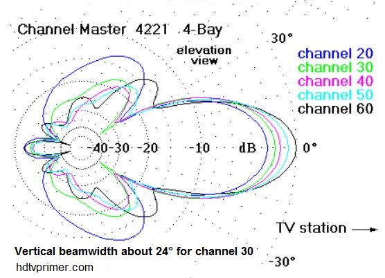

A 4-bay antenna would be better than a Yagi, because it has a narrower vertical beamwidth:

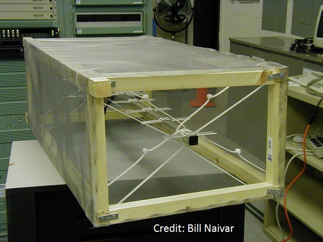

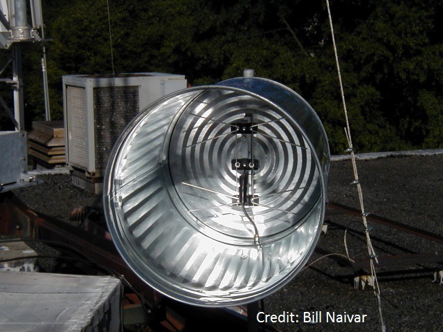

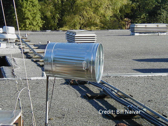

It is possible to restrict the acceptance angle of an antenna even more by putting it in an enclosure:

I just love that photo of the antenna embedded in a trash can by Bill Naivar. But I'll add a warning. If you're a guy looking to chase a difficult signal by putting an antenna in a trash can on your roof, GET YOUR WIFE'S PERMISSION! :-)
