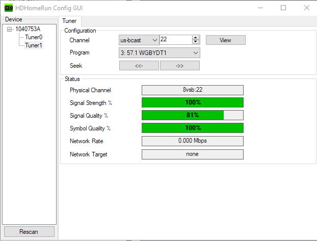

While all other channels come in great, the VHF (WWLP) is not appearing.
Doesn't show on the TV or the HDHomeRun.
I aimed it according to TV Fool, then rotated the entire antenna 360 degrees to see if the signal ever was acquired.
I'm not understanding how I can have a signal strength of 82-86% but signal quality and symbol quality of 0%.
The thumbnails are captures of both a working and this station
I'll say that WWLP is the sole VHF signal in the area, and the only one that does not display.
