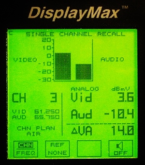

For the first measurements, I used a Blonder Tongue HAVM-1UA Frequency Agile Modulator as a stable signal source, and a Sadelco DisplayMax 800 Signal Level Meter. The modulator puts out an analog signal; I used the video carrier for each channel. The Sadelco meter has 0.1 dB resolution.
I was having a problem getting consistent measurements. The Sadelco meter has a built-in calibration reference and at certain intervals will correct its readings. This was difficult for me to deal with when making 0.1 dB resolution measurements, so I switched to my Sadelco 719E meter that has a panel meter with wide 1 dB divisions in the center of the scale that allows me to interpolate to the nearest 0.1 dB.
The Sadelco 719E is on the left; the DisplayMax 800 on the right:
I used the red divisions and the second scale -10 to +20 dBmV.
I would read that as +2.8 dBmV.
To make a measurement, I first connected the modulator to the meter with an F-81 adapter and took a reading. I then substituted the balun pair for the adapter for the second reading. If the loss of each balun is the same, then the loss of one would be half of the pair connected together.

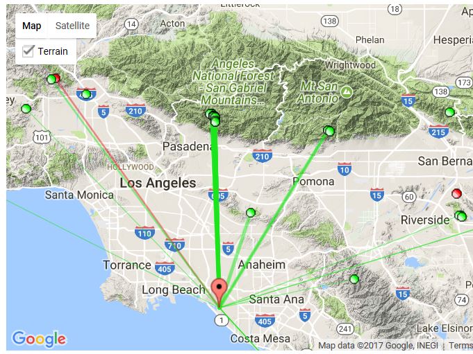

Your tvfool report looks good, but is only based on a zipcode, centered on the intersection of Le Grande Ln and Marea Cir, just south of Seal Beach National Wildlife Refuge, so it might not represent your actual location.
http://www.tvfool.com/?option=com_wr...8e03b2e1cc4490
92649 is a big area:
The green signal lines from the North look like they have a clear path:
Your generic FM signal report shows some strong signals from the North that might interfere with TV reception of VHF-High channels KTTV and KCOP:
http://www.fmfool.com/modeling/tmp/b...e/Radar-FM.png
KTTV and KCOP have directional antennas because they are in the Mexican Border Zone, so you don't get their full power sent in your direction.
