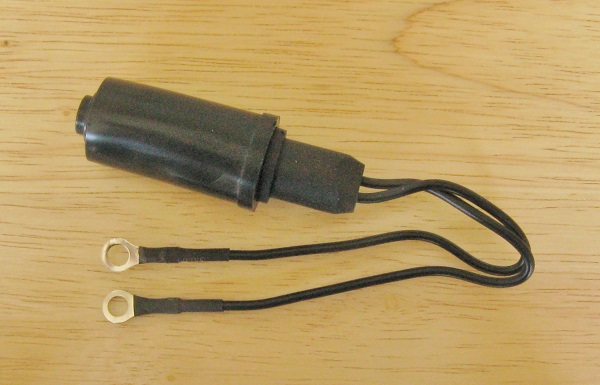

Channel Master has redesigned the 94444 balun, but has not changed the model number, just like what they did with the 7777 preamp. The new model with the ring terminals is not as good.

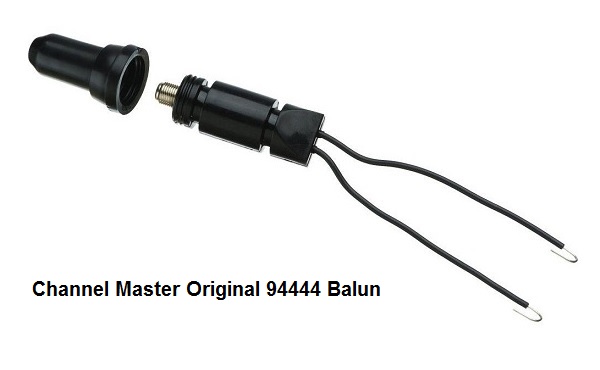

Some sellers are using the photo of the original balun, but send the new balun.
This is what the new balun looks like:
http://forum.tvfool.com/attachment.p...1&d=1497314376
This is the superior original balun:
http://forum.tvfool.com/attachment.p...1&d=1497320332

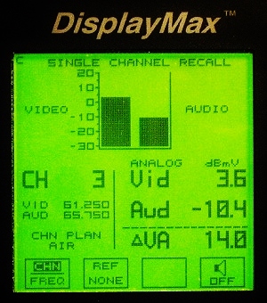

For the first measurements, I used a Blonder Tongue HAVM-1UA Frequency Agile Modulator as a stable signal source, and a Sadelco DisplayMax 800 Signal Level Meter. The modulator puts out an analog signal; I used the video carrier for each channel. The Sadelco meter has 0.1 dB resolution.
http://forum.tvfool.com/attachment.p...1&d=1498349845

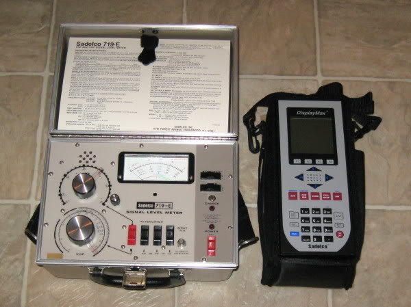

I was having a problem getting consistent measurements. The Sadelco meter has a built-in calibration reference and at certain intervals will correct its readings. This was difficult for me to deal with when making 0.1 dB resolution measurements, so I switched to my Sadelco 719E meter that has a panel meter with wide 1 dB divisions in the center of the scale that allows me to interpolate to the nearest 0.1 dB.
The Sadelco 719E is on the left; the DisplayMax 800 on the right:
http://forum.tvfool.com/attachment.p...1&d=1440873529

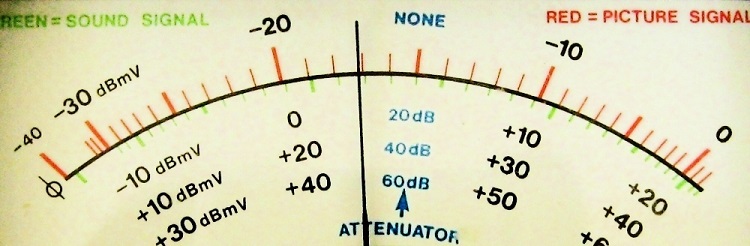

I used the red divisions and the second scale -10 to +20 dBmV.
http://forum.tvfool.com/attachment.p...1&d=1498343067
I would read that as +2.8 dBmV.
To make a measurement, I first connected the modulator to the meter with an F-81 adapter and took a reading. I then substituted the balun pair for the adapter for the second reading. If the loss of each balun is the same, then the loss of one would be half of the pair connected together.

When I was making the measurements of the New CM balun, I noticed the loss readings would vary according to the position of the 300 ohm wires between them. I decided to cut the wires to 2-1/2" before removing the insulation to see of it would make any difference.
http://forum.tvfool.com/attachment.p...1&d=1498350451
I then made measurements of this modified balun:
Code:
Channel Master New 94444 Balun with 2-1/2" Wires
Ch        F-81  Bal  Dif  Ea
          ---dBmV--  --dB---
15        7.3  4.8  2.5  1.3
28        6.4  4.7  1.7  0.9
45        5.6  3.8  1.8  0.9
The loss was reduced and was much less affected by the position of the wires. The long wires formed a transmission line of indefinite impedance.
If you use the new CM balun, I suggest you keep the wires short.

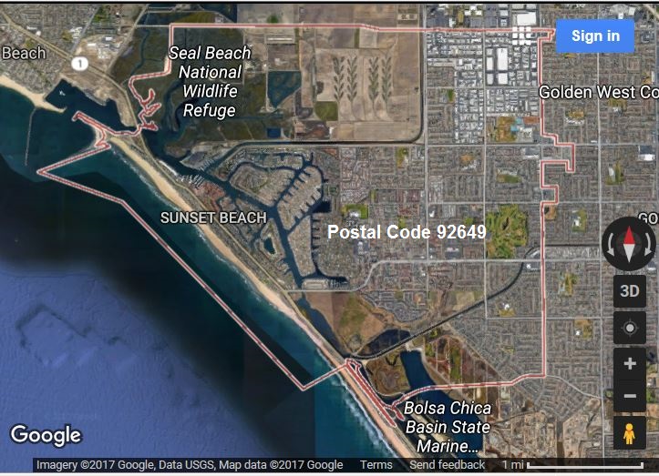

Your tvfool report looks good, but is only based on a zipcode, centered on the intersection of Le Grande Ln and Marea Cir, just south of Seal Beach National Wildlife Refuge, so it might not represent your actual location.
http://www.tvfool.com/?option=com_wr...8e03b2e1cc4490
92649 is a big area:
http://forum.tvfool.com/attachment.p...1&d=1498504762

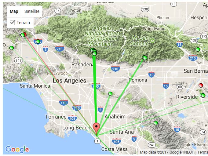

The green signal lines from the North look like they have a clear path:
http://forum.tvfool.com/attachment.p...1&d=1498505253
