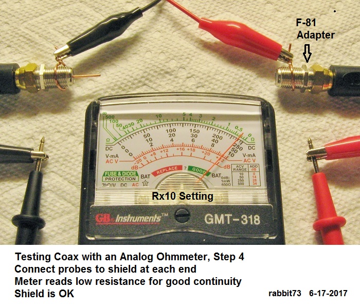

You would use the ohmmeter to check for opens or shorts in the coax when it is not connected at either end. Don't make resistance measurements with the ohmmeter with any voltage on the coax; you will zap the meter.
So I'm looking at a resistance equal or near that to the rating, which I assume is 75Ω.
No, that is the impedance of the coax for RF signals. The ohmmeter measures DC resistance, which would only be a few ohms for continuity of the center conductor from one end to the other. It would also be a few ohms for continuity of the shield from one end to the other.
If you don't have access to both ends near the meter when checking for continuity, short the far end and check between the center conductor and the shield and the end by the meter. It should be a few ohms. The test current makes a round trip out the center conductor, through the short at the far end, and then back to the meter on the shield.
To check for shorts in the coax, neither end should be connected. Make a resistance check between the center conductor and the shield at either end. It should be an open circuit, with no continuity.
Do the resistance measurements first. If the coax is OK, then do the voltage measurements.
When you make voltage measurements, start at the power inserter without the coax to the preamp connected. Measure the voltage at the connector that goes to the preamp between the center and the shield threads being careful not to short the voltage. I usually stick a short length of 18 gauge solid copper wire in the connector for the voltmeter probe.
Then connect to coax to the power inserter and check the voltage at the end of the coax that connects to the preamp. Again, be careful not to short the shield to the center conductor. I usually insert an F-81 adapter on the end of the coax and then insert a short length of 18 gauge solid copper wire as with the power iinserter.

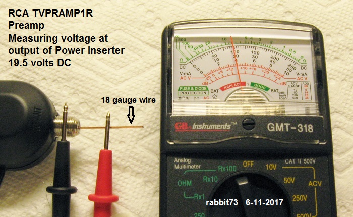

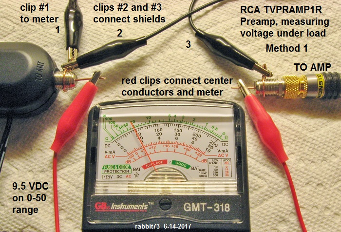

Measuring RCA TVPRAMP1R Preamp Voltage
The 18 gauge wire is the same size as the center conductor of RG6 coax. Actually, the piece of wire in the photos came from a short length of RG6 coax.
The meter switch was set to the 0-50 VDC range.
This measurement is called measuring the output voltage without a load, because the preamp is not connected.
When the preamp is connected, the voltage will drop to its normal operating level, called voltage under load.

Pete Higgins measured the RCA preamp voltages and current when he did his excellent reviews of the preamp.
http://forum.tvfool.com/showthread.php?p=49017
http://www.highdefforum.com/local-hd...amplifier.html

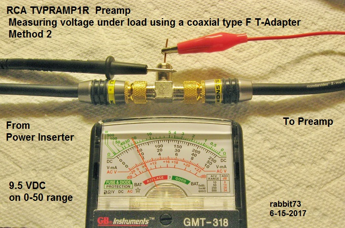

It is a little more difficult to measure the voltage under load, because you need access to the center conductor when the preamp is connected. This is one way to do it:
Method #2 is easier if you have a T-Adapter:

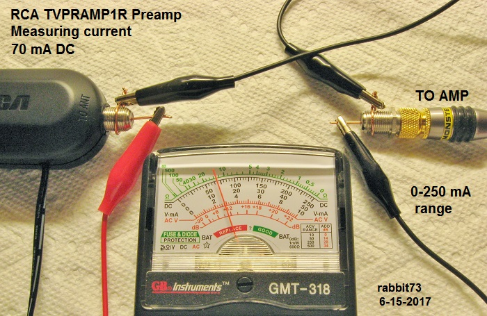

Measuring the current:

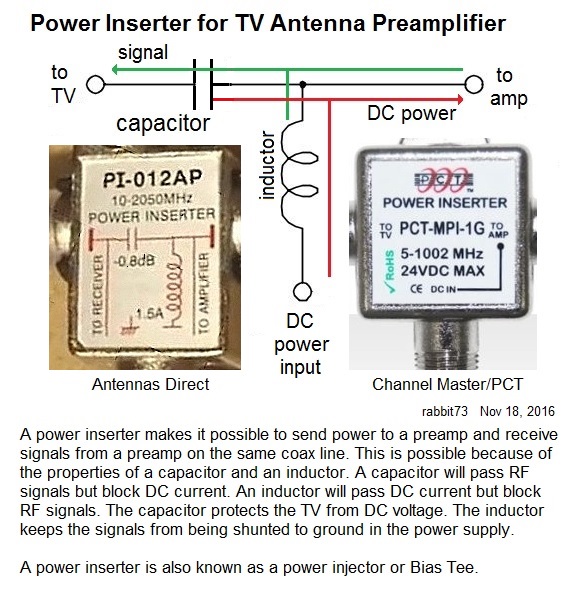

Old 16-Jun-2017, 11:34 PM   #16
Thanks for the report. We're not angry, we're glad you found out what was wrong. We learned from your mistake, too.
Yup, that's what it says.
When you turn it around, it sends the amp voltage to your TV, which survived.

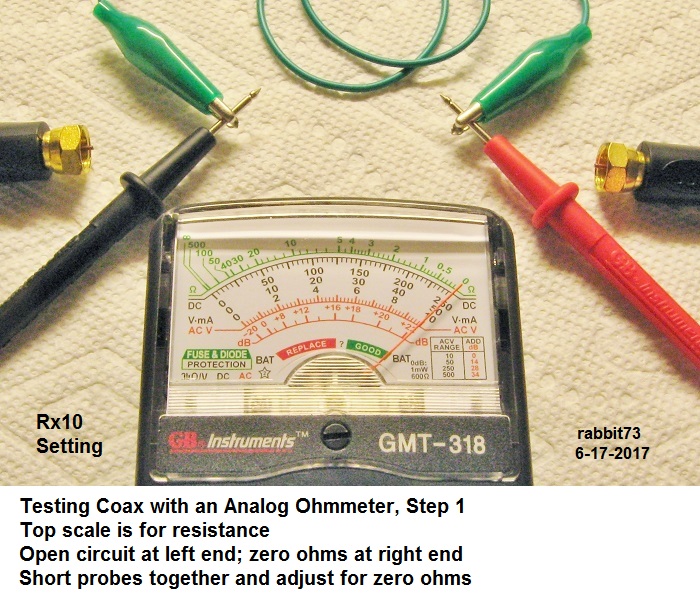

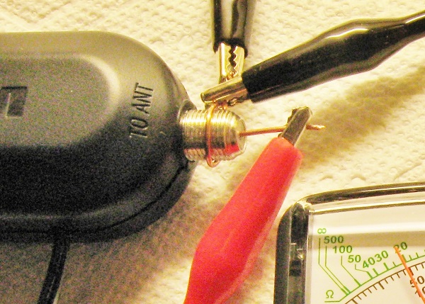

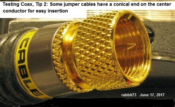

Old 18-Jun-2017, 6:22 PM   #20
Originally Posted by BigBean View Post
Now, follow me for a sec. One thing I've always tried to use to teach myself electricity is to think of it as a river. Now, when testing components such as coax, I get stuck on the terminology: Capping, shorting, terminating a component – all the same thing – is tantamount to attaching an alligator clip to one end, biting the copper wire ( the "conductor" ) while touching the negative ( here, the threading ) so it effectively creates a circuit once the multimeter is connected at the opposite end, so one can test that component?
Making a water analogy is often useful when following current flow in a circuit. Your description of a test sounds like my Step 5 when testing coax with an ohmmeter when the far end of the coax isn't near the meter. DO NOT make any resistance measurements when there is voltage on the coax. Here are all the steps:
