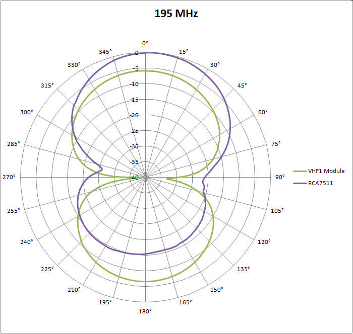

F/B ratio could be measured by performing the same set of measurements with AUT aimed 180° opposite boresite. I didn't make that particular measurement using the linear frequency sweep procedure plotted above although I did do 360° rotational patterns which would discern this behavior though for specific frequency cuts.
Here's a sample that compares the RCA7511 to our clip-on VHF module which is tuned to 195 MHz, the center of the high-VHF band. See notes following.
Notes:
1) A hardware failure in my circuit that synchronizes the SA sweep to the rotor's start of rotation forced me to manually trigger the SA sweep using a manually activated micro-switch in conjunction with activating the rotor. Consequently, the data may be easily skewed by as much as a second or two (7.5-15 degrees). Kindly overlook this shortcoming, it's particularly noticeable in the 7511's pattern.
2) The data was normalized so that the maximum point in the paired data set was set to "0" and the rest of the data was adjusted by the same amount for the purposes of this comparison. Using Excel, there are, of course, a good number of possible data display methods possible, this happens to be the one I chose as I attempt to enhance my feeble Excel and VBA skills.
3) The VHF module, if balun and insertion loss adjustments were included (they aren't at this point) would be about as close to a reference dipole as a no-budget measurement effort could produce. I may explore this later and then compare it to the BicoLOG just to see how close they are to each other. In the meantime, I'd assume a 1 dB insertion loss @195 MHz and that will get you better than in the ballpark (probably into the infield) for an estimate.
4) Using the above described F/B definition, the F/B of the dipole is measured a almost zero, the 7511 is measured at about 15 dB.
5) Using the above described gain definition and including the estimated insertion losses, I'd estimate that the forward gain of this antenna, as tested, is ~ 5 dBd (7.15 dBi) at 195 MHz.

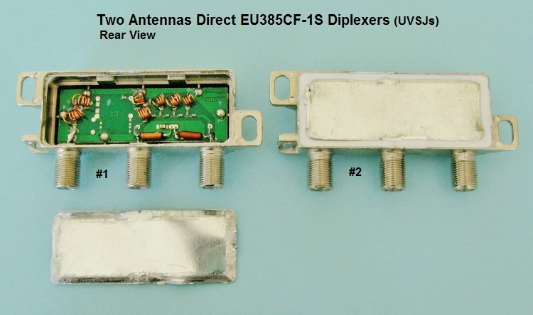

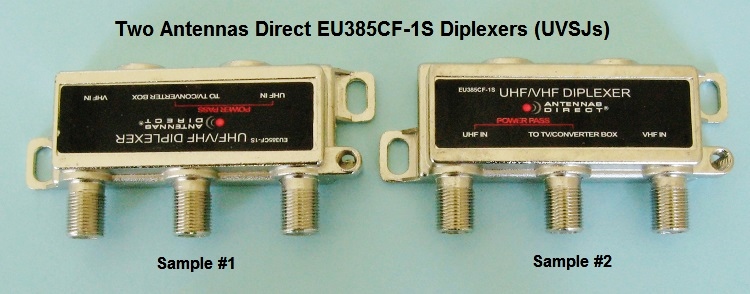

I bought two EU385CF for evaluation. I opened the black enclosure, and something didn't look right. I opened the second enclosure and it did look right.
I was able to figure it out, but if someone only purchased sample #1 with the upside down label, it might confuse them.
Sample #1 was sealed at the rear with epoxy; sample #2 with solder and epoxy, so I didn't mess with it.
Since you do QC, I thought you should know. I also called customer service to let them know, but didn't ask for an RMA because I wanted to look inside anyway to add to the AVS UVSJ thread.

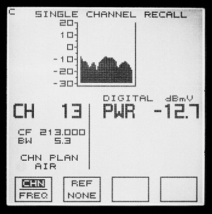

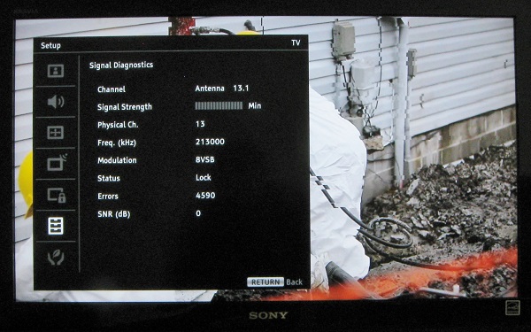

I did some more testing with my GE 34792 Attic Antenna indoors on VHF-High because CH 13 is more difficult to receive than my UHF channels.
I found a convenient location in the bedroom for the antenna and made some measurements. In this location, CH 13 is picked up by the tuner, but there is picture freeze and many uncorrected errors, not too good:
The signal level meter shows adequate signal strength, but a bad channel scan:

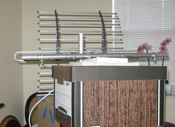

Old 6-Jun-2017, 1:59 AM   #76

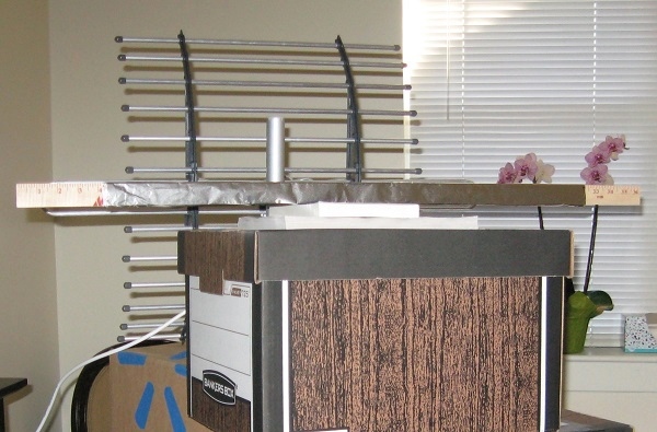

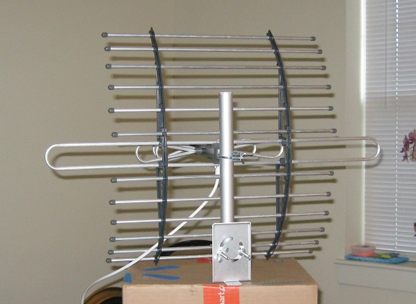

I suspected that multipath reflections were causing a problem and decided to add a reflector element to the VHF folded dipole. A cardboard box is used as a temporary support.
The reflector is 13" behind the VHF dipole and consists of a 24" length of 1" aluminum tubing with a 12" length of 7/8" tubing in each end and clamps. The length has been adjusted to 27.7". I also tried a strip of aluminum foil on a yardstick with the same results:
The reflector improves the reception:
and the scan looks a lot better:

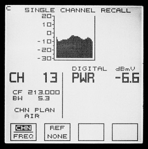

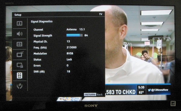

Since the convenient location for the antenna had some problems, I tried other locations in the room. The best location for the signal was in the middle of the room in a high traffic area (of course it was).
No reflector was needed in this location and the reception was excellent:
and the channel scan looks good, with increased signal strength:

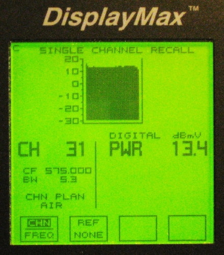

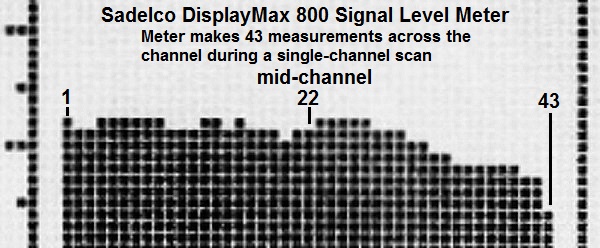

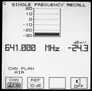

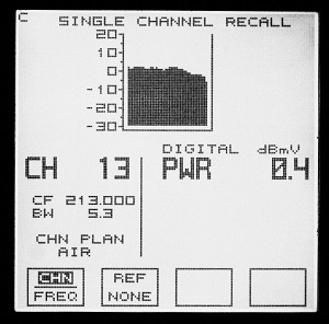

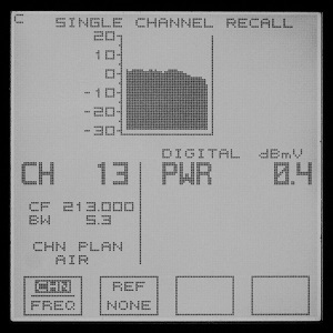

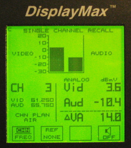

The Sadelco DislayMax 800 signal level meter makes 43 measurements across the channel and diplays the average of all readings. If one of the 43 measurements is below -20 dBmV, the meter says "Ur" for under range and doesn't give a reading. The scan covers about 5.3 MHz of the 6 MHz channel.
If the meter is switched to the single frequency mode, it will measure down to -35 dBmV at the center of the channel, but the correction for a digital signal is not added; +6.8 dB IIRC.
The screen on the meter actually shows a dark gray image on a dark green background and doesn't have much contrast. The image looks pretty good on a computer screen, but makes a muddy image on a print.
analog channel:
digital channel:
To make an image that has more contrast and room for notes, I set my digital camera for a B&W image, and then edit in Photo Gallery to increase the contrast.
Photo Gallery will only allow me to increase the contrast one time, AFAIK, so I use Lunapic to increase the contrast 4x more:
