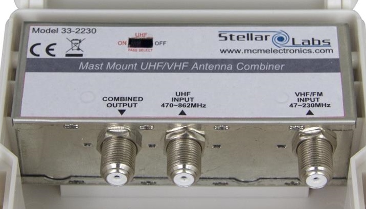

MCM also has one, but I have received mixed reports about its reliability. Maybe I'll have to order one and test it.
http://www.mcmelectronics.com/product/33-2230

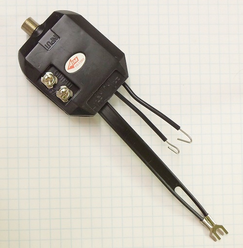

If it gets any worse, we will have to make one like in the GE 34792 Attic Antenna:
I have used the conventional terms for top and bottom of the board. The top is where the components are mounted and the bottom is where the ground plane is located. In actual use, the coax connector faces down.
The GE 34792 Attic Antenna includes a REAL UVSJ, not shorting stubs, to keep the UHF and VHF signals separated before combining. Each section of the antenna has its own balun. The UVSJ and the well designed reflector are responsible for the good performance of this antenna.
Here is a circuit of a UVSJ by SM0HX (amateur radio callsign for a ham in Sweden). The UVSJ UHF/VHF Separator-Joiner belongs to the filter family of Diplexers. All UVSJs are Diplexers, but not all Diplexers are UVSJs; Diplexer is the more general term. A HLSJ is also a Diplexer, but for VHF-Low and VHF-High.
The UHF highpass filter section has 3 series capacitors and 2 shunt inductors. The VHF lowpass filter section has 3 series inductors and 2 shunt capacitors.

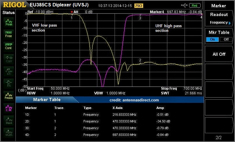

Here are the curves for the Antennas Direct UVSJ:

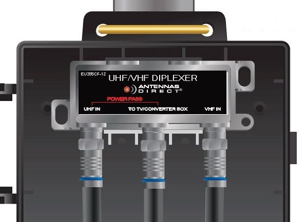

thanks AD tech. but any idea where I can score one of your UVSJ's in NW Vermont?
Will the UVSJ allow me to install it at the pole ,connecting my existing antenna to the VHF side, and the new antenna to the UHF port, and run one cable into the house.
Very important question. Will sending a signal boosted by 30Db do physical harm to my Roamio?

You would have to order it, it is not stocked in any stores. Amazon, Solid Signal, our website, etc.
Yes, BUT you will only be able to amplify either the UHF-only signals from the UHF-only antenna or amplify everything. This is an important constraint and will not allow you to amplify ONLY the VHF as recommended.
No, it will not cause any harm to the tuner. Worst case, it will simply not work very well, if at all, as long as the overload condition persists.

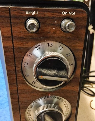

Many years ago TV sets had separate inputs for VHF and UHF. The UHF/VHF Separator Joiner was developed to separate the UHF and VHF signals coming from the antenna to feed the separate inputs for two tuners. There were also UVSJs that would combine two 300 ohm antennas for a 75 ohm input TV. Some TVs had two 2-screw 300 ohm inputs, and some had a 75 ohm coax input for VHF and a 2-screw input for UHF where you could mount a UHF loop.
Separate tuners for UHF and VHF. To tune to a UHF channel, you would set the VHF channel selector to U, and then rotate the UHF dial. The output of the UHF tuner was sent to the input of the VHF tuner:

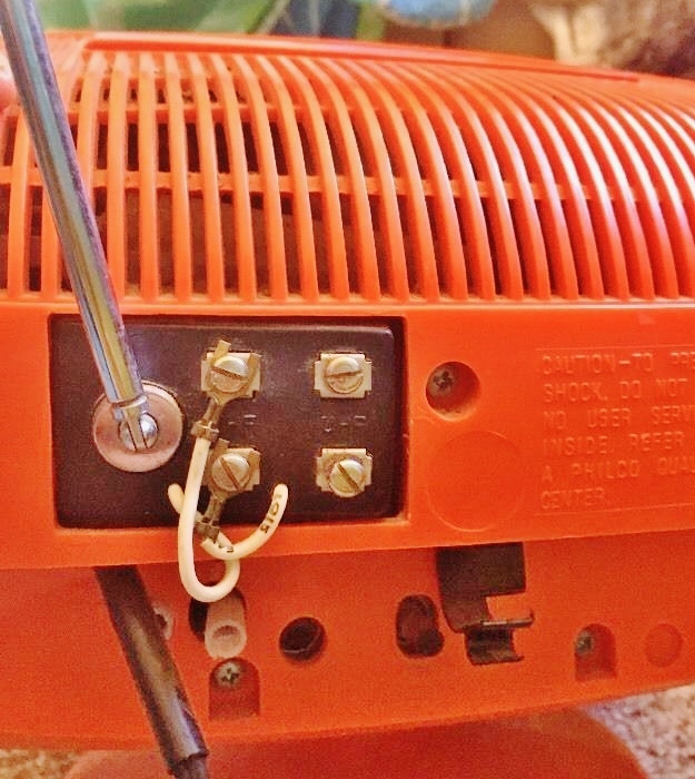

The 2 screws in the center are for VHF and have the internal antenna connected. The 2 screws on the right are for a UHF antenna:

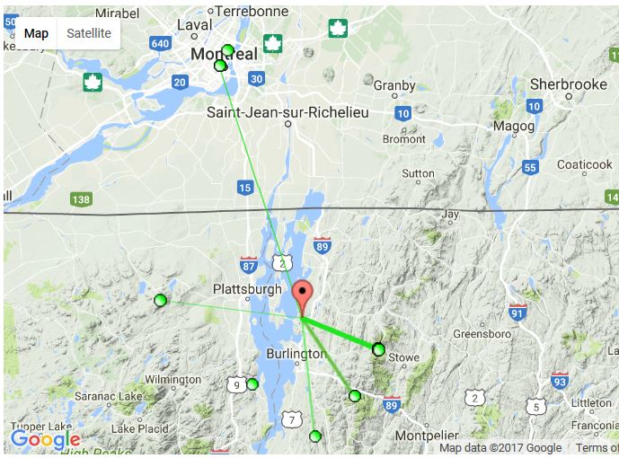

In looking at my signal analysis chart I notice that CTV channel 6 from Montreal is not shown.
Click on the "Pending" button. Industry Canada never fully updated their records that transfer into the FCC's system (which are subsequently picked up by this site's data gathering), apparently, when the Canadian digital transition took place
Also, make sure you are not confusing the virtual (displayed) channel number with the real channel number. For antenna purposes, we have to use the "real" channel number. CBMT-DT, for example, is operating on channel 21, not 6.
Old 9-May-2017, 8:01 PM   #35
In looking at my signal analysis chart I notice that CTV channel 6 from Montreal is not shown. It comes in quite well with my current set up.
CFCF CTV from Montreal is on real channel 12, virtual channel 12.1, unless all my research resources are wrong.

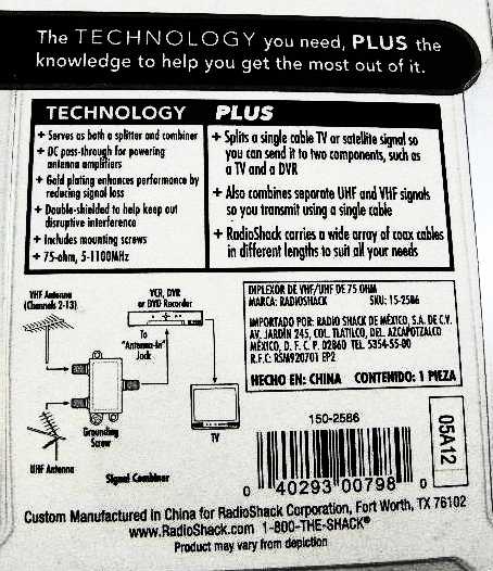

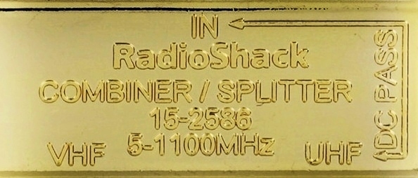

If you look closely at the Radio Shack UVSJ, you can see the DC pass arrow going to the UHF port. This would allow you to insert a preamp between the UHF antenna and the UVSJ to amplify the UHF signals, but not the VHF signals, which is not what you need.
The power pass for the Antennas Direct UVSJ is also to UHF.
The label on the Radio Shack pkg is misleading:
It is described as a splitter for two components, which is not correct.

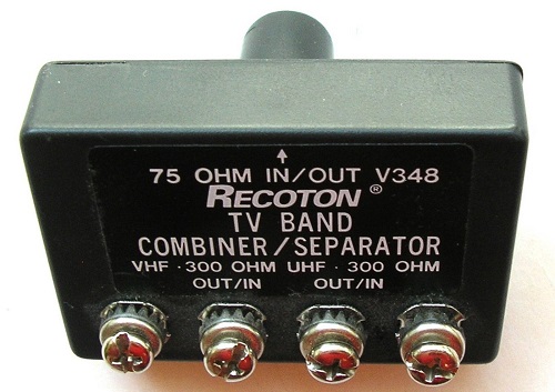

The Holland UVSJ passes DC to the VHF port, but there is no arrow:
Notice that it says Separator so that it doesn't get confused with a splitter, as happened here on this thread, creating a heated discussion:
