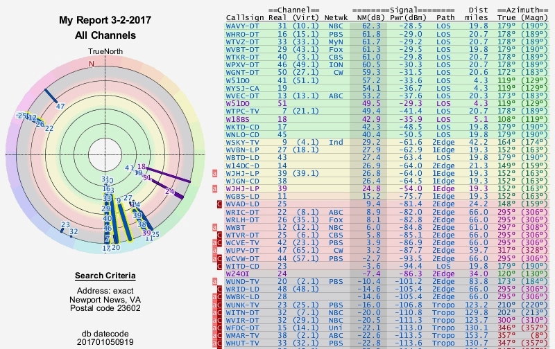

I would be very interested in your testing results of the new GE Indoor Attic Antenna. Feedback on Amazon has been surprisingly good.
I have been having a lot of fun with it. At my present location an indoor antenna is necessary for OTA reception. We also have basic cable, but I love to play with antennas and make antenna measurements.
I started experimenting with antennas when I was 8; I'm now 84. I have built many ham and TV antennas, and am still fascinated by the magic.
The GE Attic Antenna 34792 comes requiring assembly; this video showed me what to expect:
https://www.youtube.com/watch?v=1qYucg3JXzA
The signals are quite strong here, so I can get away with an indoor antenna on the ground floor, in spite of buildings and trees in the signal path. The GE antenna has more gain on UHF than on VHF-High; the UHF section is a yagi with a curved reflector, but it only has a folded dipole for VHF-High. As a result, although channel 13 is listed on my report almost as strong as the UHF signals, it is a lot weaker at the tuner because the antenna has less gain on VHF than UHF.
I have added an RCA TVPRAMP1R preamp to help 13, but I have found that the antenna location indoors is critical because of multipath reflections. Even though the signal might be strong enough, the tuner might not be able to decode it because it has reduced signal quality from multipath reflections.
Notes and photo of antenna added to screen shot of Sony Diagnostics Screen:

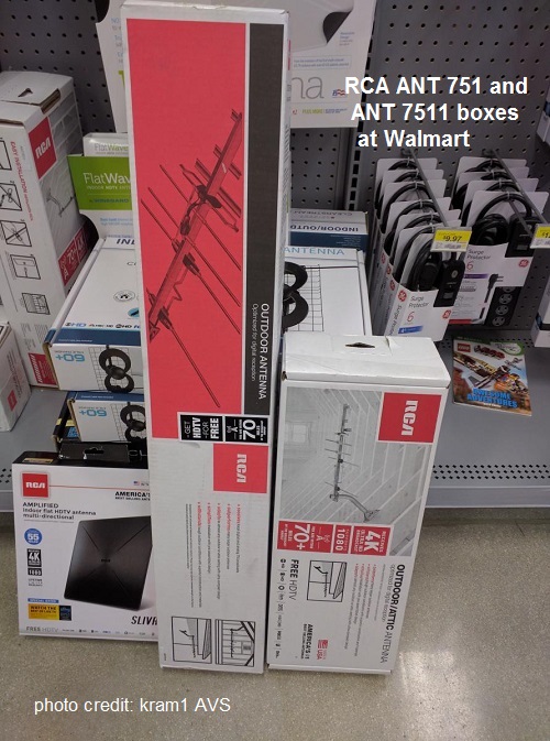

Ah, yes; I remember that thread:
first post by kram1
http://www.avsforum.com/forum/25-hdt...l#post48491929
post by kram1 showing two boxes
He said he bought the 751, but he bought the 7511
http://www.avsforum.com/forum/25-hdt...l#post48525657
post by kram1 showing ANT7511 up
http://www.avsforum.com/forum/25-hdt...l#post49316025
post by holl_ands that you quoted
http://www.avsforum.com/forum/25-hdt...l#post49348785
The gain figures that holl_ands gave are only estimates, but I am inclined to agree with him. He is very good at antenna modeling, but isn't able to model LPDAs with great accuracy because of software limitations.

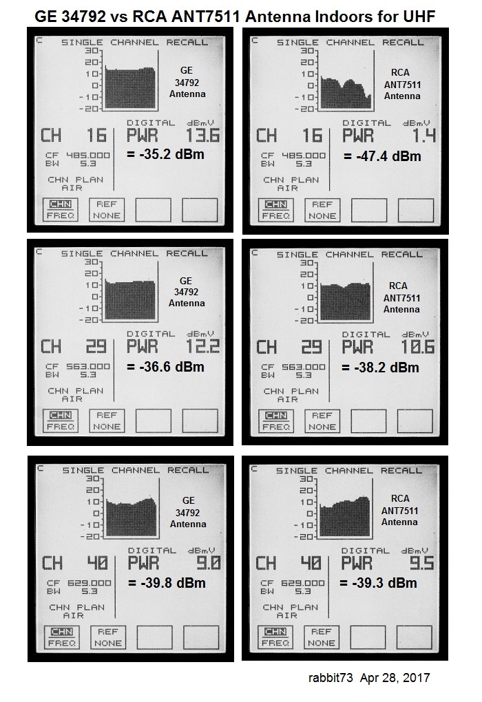

I made some measurements indoors to compare the GE 34792 Attic Antenna with the RCA ANT7511 Antenna. They are not exactly antenna test range measurements that an engineer would do, and they are not quite as accurate as I used to be able to do when I mounted two antennas side-by-side on my car and used stable LOS signals. But, I think they are useful because I used my Sadelco DisplayMax 800 Signal Level Meter in the single channel scan mode.
The meter makes many measurements across a TV channel during a single channel scan, as a spectrum analyzer would do, and calculates the average of all the measurements. I used an RCA TVPRAMP1R preamp and a splitter to feed the meter and my Sony KDL32R400A TV.
The GE antenna did a little better on channel 7, even though it only has a folded dipole for VHF. The RCA antenna did better on channel 13, as would be expected with 3 VHF elements.
UHF comparison coming soon.
Old 28-Apr-2017, 10:45 PM   #30
The GE antenna is much better on channel 16, and a little better on 29, than the RCA ANT7511 (at this location). The RCA doesn't look like it would be suitable for UHF after repack, but please keep in mind that my measurements indicate how the antennas performed at my location and it might not be an accurate indication of the actual gain of the antennas.

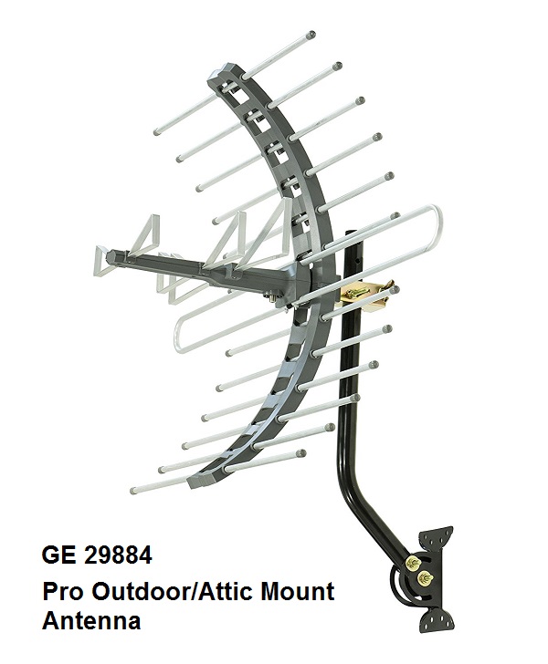

And I see they now have an outdoor version of the same antenna. It might be worth further investigation???
Thanks; I didn't know about that. Is it the GE 29884 Pro Outdoor/Attic Mount Antenna? Click on Outdoor 70 mile version:
https://www.amazon.com/GE-33692-Atti...00DNJZ58M?th=1
But what is surprising is how good the GE Indoor/Attic performed in your location, compared to both the RCAs.
My guess is the reflector design helps the UHF gain a lot. The directors look like director pairs as in the Winegard patent. But, I haven't figured out the driven element that looks like a long dipole instead of a tetrapole or how the UHF yagi and the VHF dipole are combined. I'm not quite ready to open it up to find out, but the urge is getting very strong.
Please keep in mind what I said above. My measurements indicate how the antennas performed at my location, but they might not be a reliable indicator of the actual gain of the antennas.
I feel like I'm back in school and really enjoying both you "professor's" lectures!! I'm doing a lot of homework, but ever learning.
This "professor" is still learning too, even after 76 years of antenna experiments.

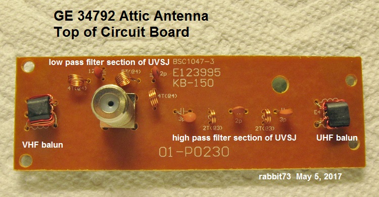

Inside the GE 34792 Attic Antenna
Originally Posted by OTAFAN View Post
If you decide to open your GE Indoor up and discover its mysteries, I'll be interest, rabbit73.
Well, here it is:
I have used the conventional terms for top and bottom of the board. The top is where the components are mounted and the bottom is where the ground plane is located. In actual use, the coax connector faces down.

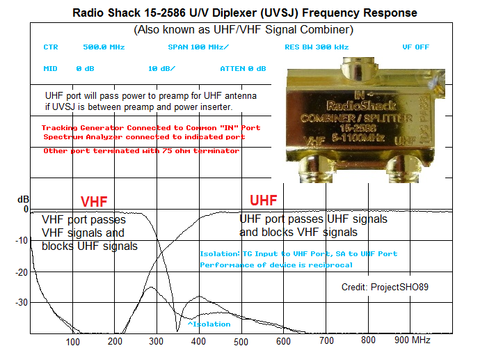

The GE 34792 Attic Antenna includes a REAL UVSJ, not shorting stubs, to keep the UHF and VHF signals separated before combining. Each section of the antenna has its own balun. The UVSJ and the well designed reflector are responsible for the good performance of this antenna.
Here is a circuit of a UVSJ by SM0HX (amateur radio callsign for a ham in Sweden). The UVSJ UHF/VHF Separator-Joiner belongs to the filter family of Diplexers. All UVSJs are Diplexers, but not all Diplexers are UVSJs; Diplexer is the more general term. A HLSJ is also a Diplexer, but for VHF-Low and VHF-High.
The UHF highpass filter section has 3 series capacitors and 2 shunt inductors. The VHF lowpass filter section has 3 series inductors and 2 shunt capacitors.
Here are the curves for the Radio Shack UVSJ:
