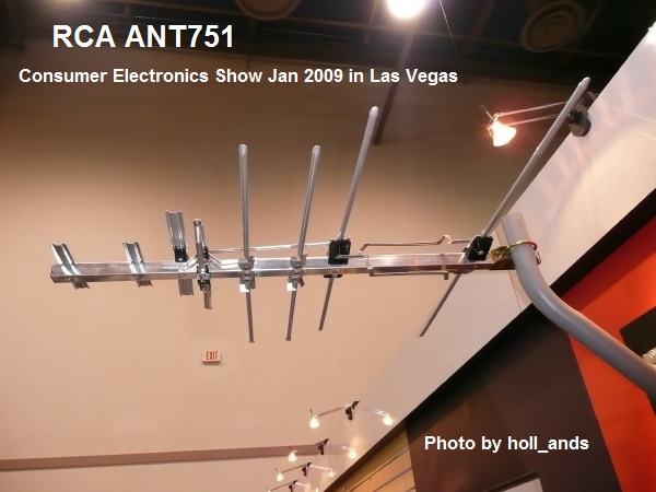

Which elements on the boom of the RCA ANT751 are for UHF and VHF High reception? I've had good use of this antenna for some time now, but was a bit confused as to which are being used for the various TV frequencies; especially since it does not have a reflector behind the UHF elements as is typical. Any help would be appreciated. Thanks! OTAFAN
Old 12-Apr-2017, 12:59 AM   #2
are for UHF
The short ones.
VHF High
The long ones.
Old 12-Apr-2017, 1:29 AM   #3
OTAFAN
Join Date: Apr 2015
Posts: 261
Rca ant751
Well, that's interesting ADTech. So, there's 3 short UHF antenna elements in front and 4 long VHF High elements, although there is a gap between the first 3 longer elements and the last longest element at the far back of the boom. Any idea what that gap is for? And with so few elements on the ANT751, it really is quite a good performer across the TV frequencies. At least it has been for me. Any idea what its secret for success has been? Thanks again for your help!
Old 12-Apr-2017, 1:53 AM   #4

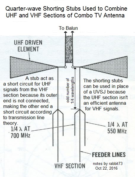

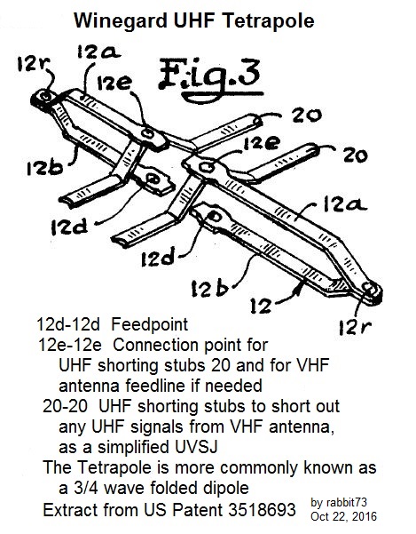

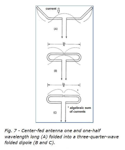

One secret is that the UHF driven element is a tetrapole, in the original version of the 751.
RCA likes to change the design in mid stream without changing the model number, usually to meet a price point with the loss of some performance.
Another secret is that the VHF section is an LPDA.
Another secret is that it is an original Winegard design.
A lot of good reports from users in strong signal areas.

Wow, thanks for the antenna primer, rabbit73! I appreciate better now my antenna set up. BTW, I called RCA earlier and asked them the same question I posed on this forum. The CS Rep told me in no uncertain, but friendly terms, that they could NOT answer my question because it was "proprietary information." ???!!! I pressed them for an answer since their antenna was a yagi design and had been around for nearly a century, but to no avail. I didn't understand the secrecy in this case. But tight lipped they remained. So, thanks again to TV Fool for revealing the mysteries of TV antenna theory for dummies like me! You folks are very much appreciated!! OTAFAN now more enlightened.....
Old 12-Apr-2017, 2:45 AM   #6
The UHF section is a yagi, but the VHF section is not a yagi, it is a LPDA.
https://en.wikipedia.org/wiki/Log-periodic_antenna
Old 12-Apr-2017, 3:15 AM   #7
OTAFAN
Join Date: Apr 2015
Posts: 261
Smile Rca ant751
Yes, understood rabbit73. I see that this antenna is a combination that I didn't know about before. You certainly have clarified the issue. Unfortunately, RCA wasn't able to educate me further in this good hobby of mine. But as long as we have TV Fool.....

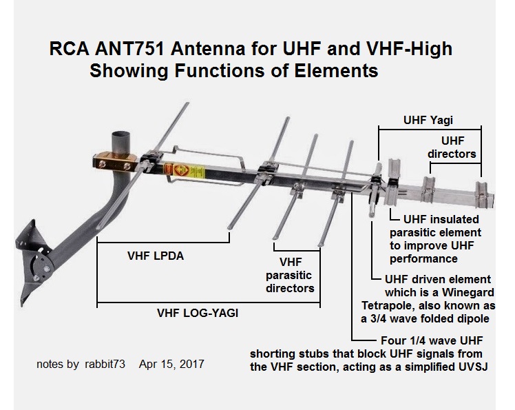

The UHF section is a simple UHF Yagi structure with a parasitic element that is probably there to flatten the bandwidth.
The VHF section, is not a Yagi as the two rear most elements are connected to each other with phasing lines which excludes that section from being a conventional Yagi but is rather a log-periodic design. The two long elements clipped to the underside of the boom are probably there for the same reason as the parasitic element on the UHF side.
I haven't tried modelling the antenna (not my cup of tea) but I did test it on my backyard antenna test range late last summer and compared it to several other antennas. Might have to dig out those spreadsheets and see what things look like.
Old 15-Apr-2017, 8:31 PM   #12
I agree.
The two long elements on the underside are parasitic directors for VHF-High, which would make the four rear elements a hybrid called a log-yagi for VHF-High.

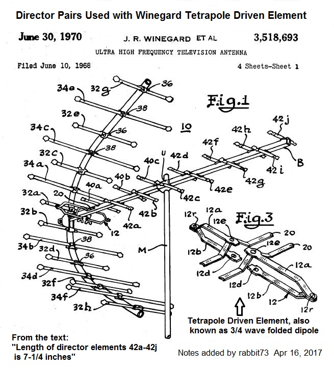

Diagram revised:
I suspect that the insulated UHF parasitic element in front of the UHF driven element Tetrapole is actually a pair of side-by-side directors that you also see in high gain UHF yagis by other manufacturers. The Tetrapole, AKA 3/4 wave folded dipole, has two current loops that allow the use of pairs of directors in front of it for maximum gain. But, I can't be certain until I have a 751 in front of me to confirm it.
You can see the idea of director pairs in Winegard patent 3,518,693. The patent drawing shows pairs of directors, but the patent text claims "a plurality of director elements."

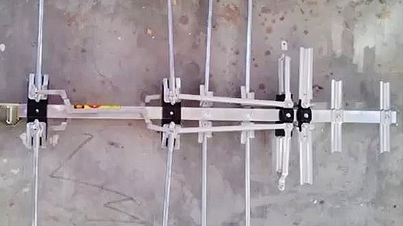

Definitely a pair of directors in front of the Tetrapole.

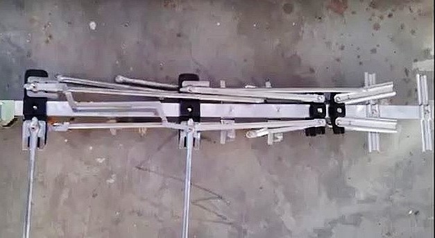

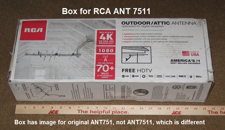

CAUTION, there is a new version being sold, and they are using the photo of the original ANT751; very misleading.
RCA Suburban Mini Yagi Digital Outdoor Antenna with Mast, now model ANT7511
Differences:
1. The mast clamp is now ahead of the rear element
2. There is only one VHF director
3. The 4 shorting stubs have been replaced with 2 small-diameter wires, each 5-1/2" long
4. The Tetrapole has been replaced with a long dipole driven element; 6-1/2" long on each side
5. The UHF director pair in front of the Tetrapole has been replaced with a conventional director, for a total of 3 directors, each 7" long

Not only are the companies that are selling the ANT7511 using the image of the original ANT751, but the box for the ANT7511 has images of the original ANT751. The worker that pasted the ANT7511 sticker on the box, put it on at an angle, so that it is possible to see the printing ANT752Z.
My guess it that first RCA wanted a smaller box, so they made the boom in two pieces. Then, they said why stop there, let's see what we can remove to cut costs even more, so the ANT7511 was born......Ugh!
