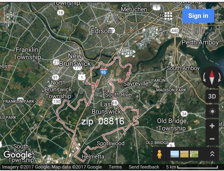

Thanks for the tvfool report, but East Brunswick 08816 is a very large zip code; we need a more accurate report by exact address (which will not show) or coordinates (which will be truncated) of your antenna to give accurate advice. I grew up in Metuchen, so I am familiar with the area from New Brunswick to Perth Amboy.
Tips for doing a more accurate report:
A reliable method for generating a TV Fool Reception Report
http://forum.tvfool.com/showthread.php?t=14508
