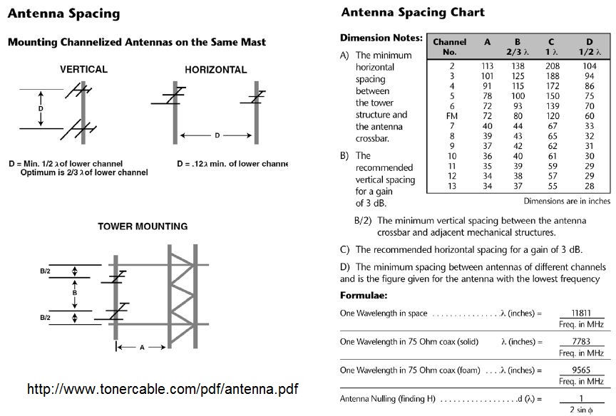

Thank you Rabbit73, I'll give it a try. One more question. I have an FM antenna on that mast. How far apart should they be?

About 4 to 5 feet; but you can try 3 feet if you don't have the room.
https://www.tonercable.com/pdf/antenna.pdf
