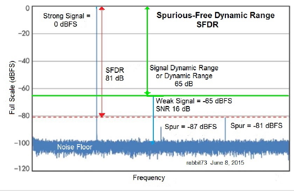

You might need some attenuation after the preamp power inserter to prevent tuner overload. The signal dynamic range between CH 16 and CH 12 will be about 36 dB, for a required SFDR (Spurious-Free Dynamic Range) of 52 dB after adding the minimum required SNR of 16 dB for CH 12.
