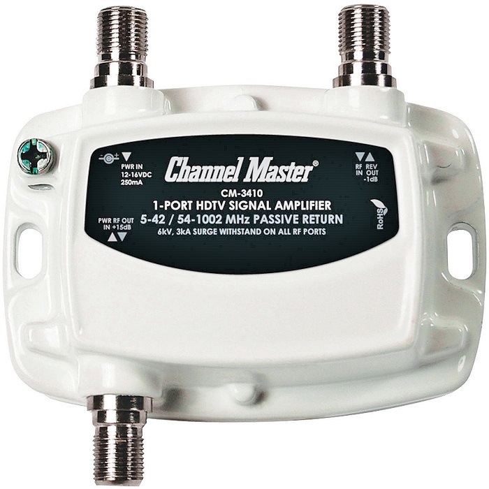

If you have AC power at the first splitter, the DC power for the Channel Master 3410 goes in the upper left port. If you do not have AC power at the first splitter, then you must provide remote DC power for the 3410 through the first 50' run using a power inserter just before the second splitter.
I am suggesting the 3410 and 2-way splitters instead of the 3414 so that you can send more signal to the longer runs for better balance.
The PCT-MA2-M is the same as the CM3410.
These diagrams are for the 3414, but it works the same way for the 3410. I am suggesting the 3410 and 2-way splitters instead of the 3414 so that you can send more signal to the longer runs for better balance.
In your case where the second diagram says To TV 3, it would be to second splitter.
