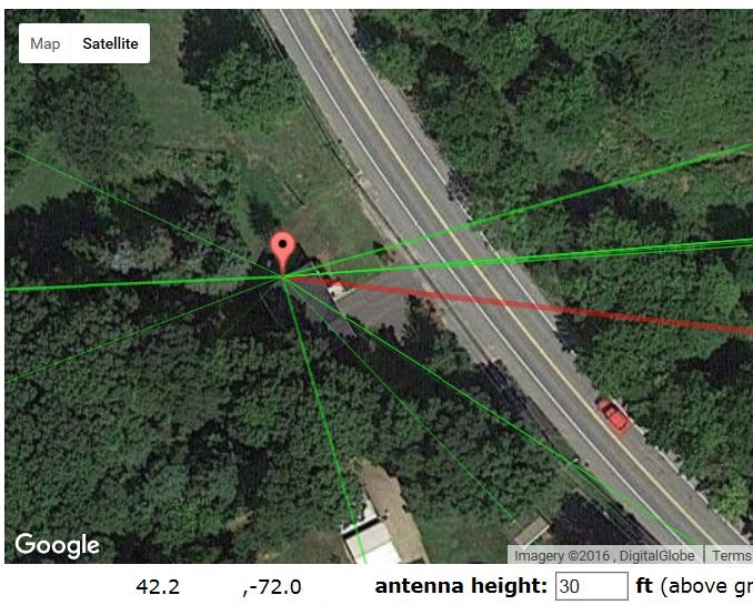

42._____,-72.____ is the location of my antenna. I didn't see a way to share the google map directly. It's about 30ft off the ground above the roof line.
I am using a Mohu Sky HD for a UFH antenna. Yes it's one of those all in one antennas that comes with the little power block and has the pre-amp built in. Until this NBC change this antenna has done really really well and my wife loved the size of it. She didn't want one of the typical style ones up on the roof and this worked great so I didn't argue.
Yes I put it on a rotator.
Trees are mostly on the western part of the house. All other sides have a good distance between any trees.
I have 4 different tvs in the house each of a different brand, Sony, LG, Samsung, & Sharp. I also have a distribution amp in the basement just after the two antennas UHF & VHF combine to a single wire but before the splitter that goes to each tv.

Thank you for the coordinates. You can delete them to protect your identity if you wish.
This is the report for your antenna using coordinates:
http://www.tvfool.com/?option=com_wr...dfafc2e7234cbc

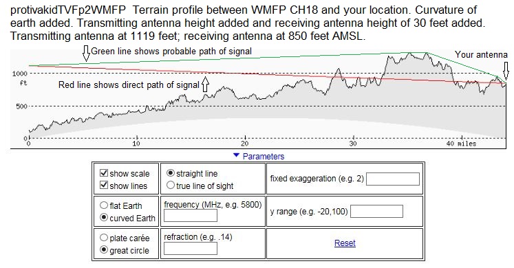

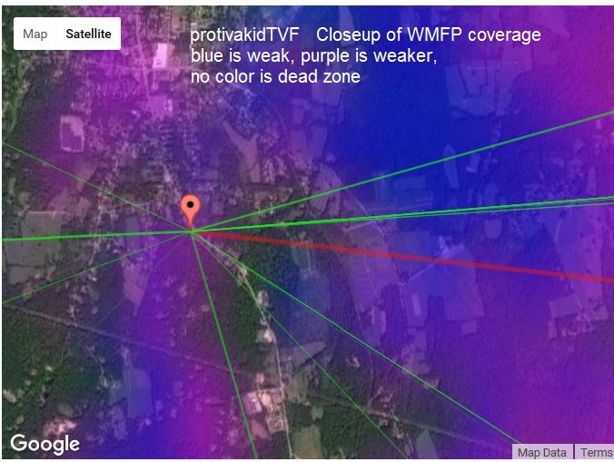

Ah, yes; I see the trees to the west.
You are on the extreme fringe of coverage for WMFP. Note that only 143 kW out of 1000 kW ERP is sent in your direction:
You would need a high gain UHF antenna and a preamp for any chance at that.
It would probably help to tilt the front of the antenna up. The Antennas Direct 91XG and the Solid Signal HDB91X have the tilt feature. The DB8E has more gain for channel 18 with both panels aimed in the same direction, but it doesn't have a tilt adjustment; it would be a custom mod.

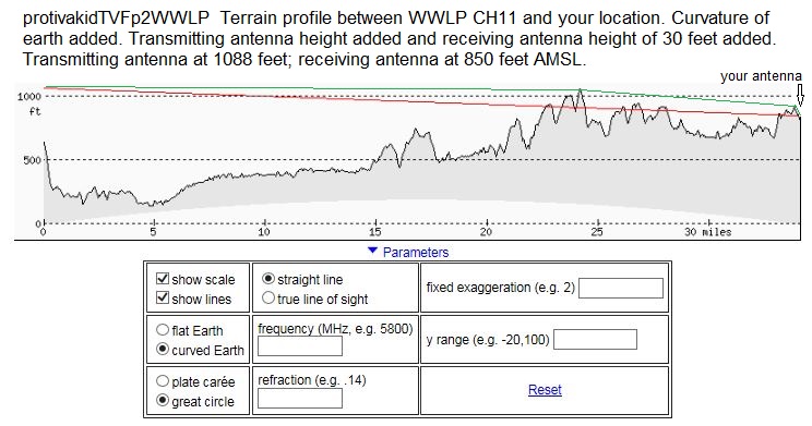

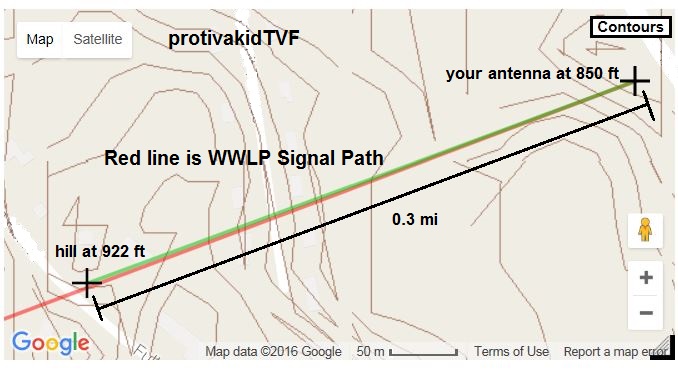

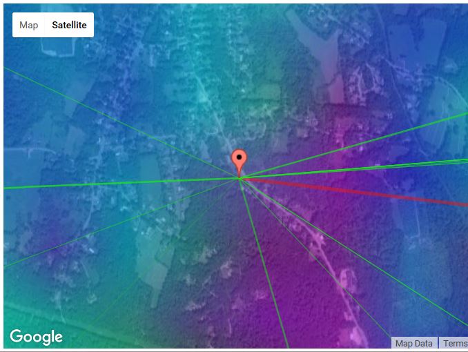

Old 17-Dec-2016, 5:40 PM   #11
Contrary to the results I can NOT get WWLP at my current height even if I point my AntennaCraft (Y5-7-13) right toward it. There is also a hill directly that way. Normally I use this VHF only antenna for WNAC and keep it aimed that way.
Yes, you would think so. The tvfool report knows about the hill, but it doesn't know about the trees in the WWLP signal path. Trees block TV signals.
That little hill only 0.3 mi away is a problem.
An MCM 30-2476 with the front end tilted up and a preamp might pick it up.

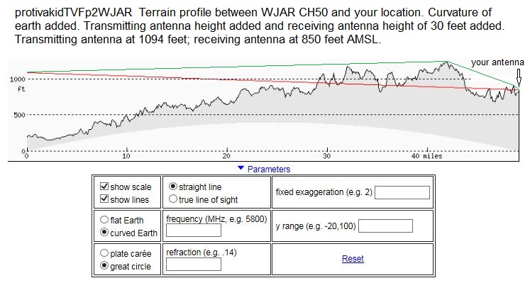

The only other NBC station that I can sometimes get is WJAR and that requires aiming my UHF antenna in the direction of WNAC and even then the signal is not consistent. I also lose the Boston stations like WCVB.
WJAR coverage:
Think I will need to add a second UHF antenna and rig something up in the hopes of getting WJAR?
An Antennas Direct 91XG or a Solid Signal HDB91X with the front end tilted up and a preamp might work.

I was actually able to pick up WJAR Saturday night however now today it is gone. Is there a decent way to combine the two different types of uhf antennas so I can keep the Mohu pointed toward boston and one of the above toward WJAR? With the pre-amp built into the Mohu I am guessing I would have to combine down in the basement.

Old 19-Dec-2016, 10:06 PM   #14
Is this better than the other VHF antenna I already have?
In theory the 2476 has a little more gain than your VHF antenna, but I don't know of any actual measurements that compared them. The 2476 also has a tilt feature that might help.
All of your NBC signals have problems; you must be prepared to experiment.

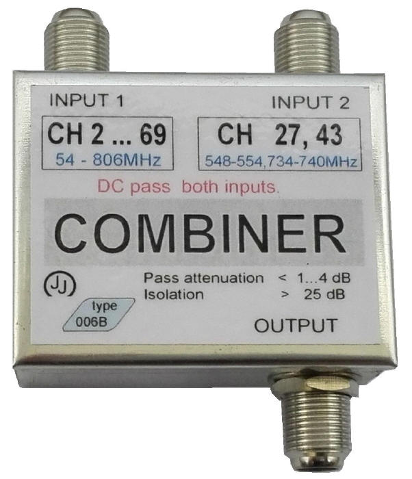

Combining two UHF antennas aimed in different directions is not easily done. Sometimes it works, sometime not. If you use a splitter in reverse as a combiner after the power inserters for the preamps, when the same signals from each antenna reach the combining point, they might interfere with each other if they don't arrive in phase (at the same instant).
I suggest you try another antenna and preamp for WJAR without combining. If it works, then try combining. If you don't get all the channels you had when the antennas were separate, then combining that way will not work for you.
If the combining doesn't work, you have several alternatives.
1. You can run the NBC antenna coax to just one TV, and have an A/B switch to select which antenna is needed. You might need to rescan if that TV isn't able to add a channel after scan.
2. You can run the main antenna system to the TV antenna input, and connect the NBC antenna to a separate tuner, like the CM7003, with its output connected to the TV aux input.
http://www.avsforum.com/forum/186-co...erter-box.html
3. If you want NBC added to the main coax for all TVs, you will need a custom combiner for that NBC channel, made by Tin Lee Electronics, which will be more than $100.
http://www.tinlee.com/PDF/AC7-custom...kup%20Info.pdf
Jan Jenca, in Slovakia, sells a less expensive version on ebay.
http://www.antenne-komponenty.eu/eng...zlucovace.html
