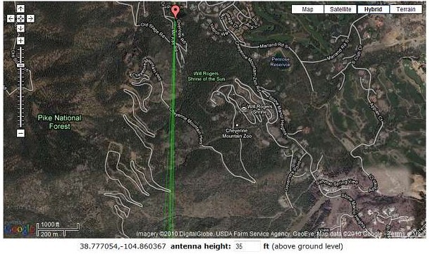

So, I re-did the interactive map thing with a couple different #'s as to height, and they are:
http://www.tvfool.com/?option=com_wr...27ee170c7fc913
http://www.tvfool.com/?option=com_wr...27ee8720ea782a
also, a screengrab of hybrid map showing terrain for reference is attached below.

Originally Posted by Freeduh View Post
the ones I would like to get are some of the red, and the first 2 into the gray-all of the rest down not so much in fact don't care at all!
You probably have a good shot at the channels to your south (around compass heading 173) down into the red zone, but I'm not so sure about the ones in the gray because they are coming from different directions. You can only have your antenna point at one direction at a time, so the only way to try for these other stations is to use an antenna rotator.
