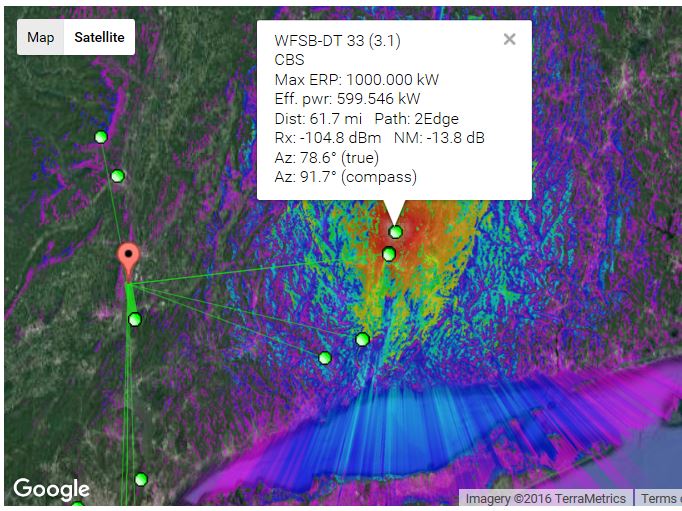

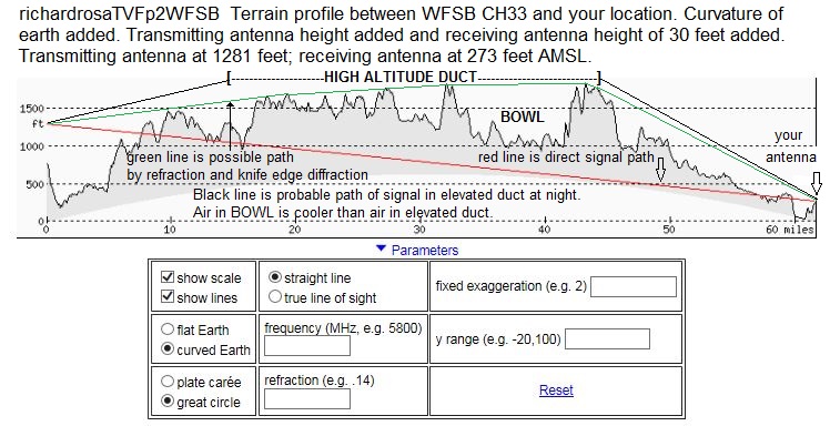

The other weirdness relates to another Connecticut channel, WFSB (Channel 33).
From about 9pm at night to about 7 to 8am in the morning, the signal is good, and reception is clear. Around 8 in the morning the signal starts fading dramatically. By 10am there is NO signal at all (as per the F.S. Meter)
According to the maps, the transmitter site is fairly close to the WVIT transmitter, so I would expect similar propagation characteristics.
Although there is probably not much I can do about the signal. I AM curious as to why this phenomena is happening. I did NOT think that UHF frequencies were affect by daily changes in the upper ionosphere. Yet this channel (and this channel alone) seems to be behaving like an AM radio signal.

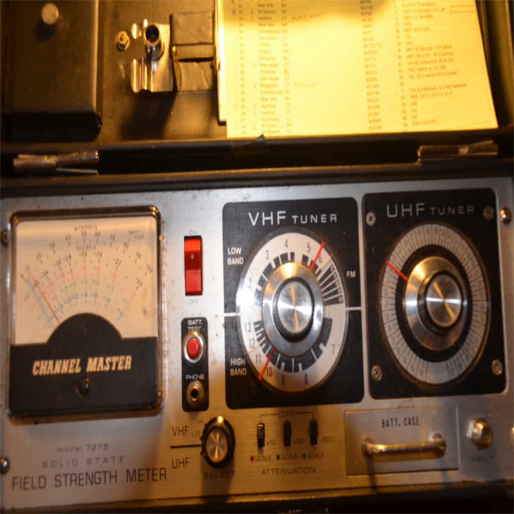

I have an old, analogue Field Strength Meter that I have been using to adjust the direction of the antennas.
What make and model? I am interested in FSMs and signal level meters (SLMs), and enjoy making measurements as you might notice in my signature.

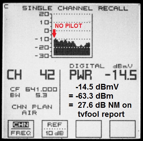

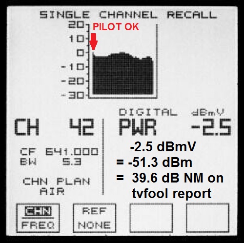

If my tuner is not able to pick up a channel durng a scan, I use the same technique that you use. I try to make a measurement of the signal strength to see if is even there.
http://www.avsforum.com/forum/25-hdt...l#post22105317
This signal is strong enough, but the signal quality (SNR and uncorrected errors) is poor, so it can't be decoded.
The antenna was moved to another location, and the signal was picked up during a scan and could be decoded:

The F.S.M. is a Channel Master Model 7275 leftover from my younger days (40+ years ago) as an MATV/CATV tech.

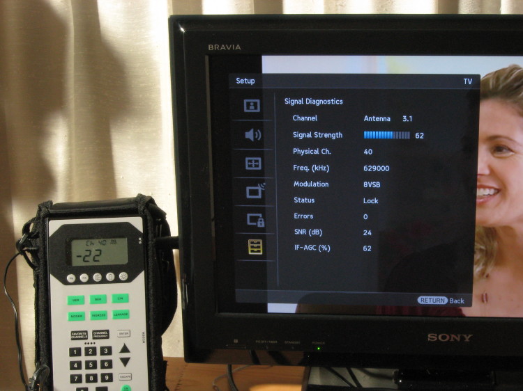

My Sadelco 719E was about $600 when I retired in 1988. It was designed for analog signals, but I found it very useful for digital signals. The DisplayMax800 and DisplayMax 5000 ran about $1000. My wife gave the last 2 to me as a present. She tolerated my antenna experiments because she wanted a battery operated TV for use during power failures. The 719E on the left, 800 on the right.
DM5000 in use; Sony KDL22L5000. Disabled 1/10 dB for photo.
My Sony KDL32R400A has a Diagnostics Screen that gives signal strength numbers in one dB steps, so I got a TV and an SLM for the same price as a TV. Here is the calibration chart I made:

If I did this correctly, a photo of my meter is attached.

Thanks for the photo of your FSM. I am always interested in old meters. If your meter still works, it is entirely adequate for your needs.

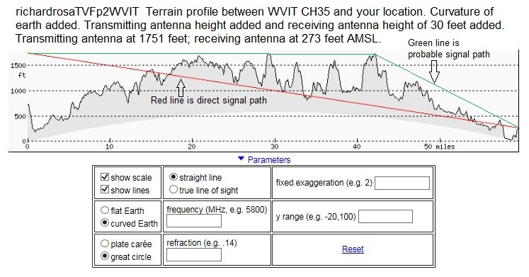

In addition, WNYW in NYC appears to have built a satellite station on Mt. Beacon on channel 32. Even though I have Line-of-sight to the transmitter, the signal is marginal, and not always reliable.
I suspect that the transmitter antenna is highly directional and is being 'beamed' in a direction outside of my area.
That is correct; only 0.001 kW (1 watt) out of 1.000 kW (1,000 watts) is sent your way because of the transmitter antenna array.

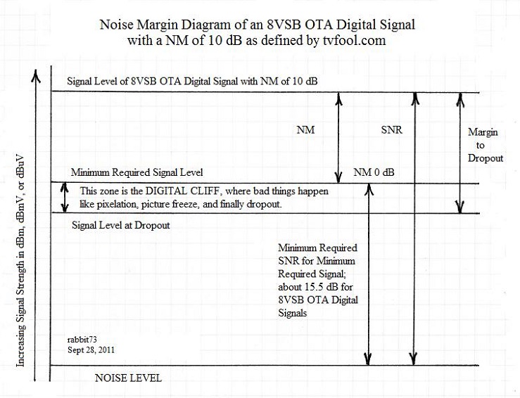

What is happening is the difference between the strongest channels and the weakest channels is too great. This is called the dynamic range. If you need a preamp for the weakest channels, but a preamp will be overloaded by the strongest channels, then the dynamic range is too great.
You don't have just one very strong channel, you have two; that's what it takes to create IMD (Intermodulation Distortion) which produces spurious signals that come up from the noise floor and reduce the SNR of your weakest to below 15 dB making them impossible to decode. You are also creating fundamental overload that produces gain compression and harmonic distortion.
The Dynamic Range is measured from the top of the weakest desired signal to the top of strongest signal. The SFDR is the Dynamic Range plus the minimum required 16 dB SNR of the weakest required signal to keep the spurious signals ("spurs") below the noise floor of the weakest desired signal.
WRNN has a Noise Margin of 68.5 dB. If you add a conservative antenna gain of 14 dB, that brings you up to 82.5 dB, which is overload territory even before adding preamp gain.
Looking at it in terms of signal strength (power) WRNN has a signal power of -22.3 dBm.
-22.3 dBm + 14 dB ant gain + 22 dB preamp = +13.7 dBm; tuner overload

It sounds like your reception of Ch 33 is dependent upon a temperature inversion bending the signal back to earth. In some areas it is quite common for slight temperature inversions that enhance VHF/UHF signal propagation to form on an almost daily basis right after sunset, and last through mid morning. I think this site explains it better then I can.
http://www.dxinfocentre.com/propagation/tr-modes.htm
Scroll down to Tropospheric Enhancement (TrE).
This quite common in my area, but Tropospheric Ducting (TrD) is very rare in this part of the country.

Old 22-Oct-2016, 12:00 AM   #15
RF Steve is correct about the temperature differential making reception at night possible.
http://www.mike-willis.com/Tutorial/PF6.htm
http://www.dxfm.com/content/propagation.htm
This is the terrain profile for WFSB shown by tvfool:
http://www.tvfool.com/?option=com_wr...ALLTV%26n%3d20
This is the WFSB terrain profile using different software:
The path for the WVIT signal is a lot easier. Note that the WVIT transmitting antenna is much higher than the WFSB transmitting antenna.
Here is a coverage map for WFSB; you are on the extreme fringe:
And a closeup:
Another problem with WFSB is that it has co-channel interference from WCBS on the same channel. WFSB needs to be at least 16 dB stronger than WCBS for reception. Since it is in a different direction, the antenna pattern helps to make WCBS weaker.

WFSB has a Noise Margin of -13 dB, which is only 2 dB above the thermal noise floor at -15 dB NM. It is difficult to receive any channel with a NM less than -10 dB. If you are able to receive a channel with a listed NM of less than -10 dB, you have an excellent antenna system, your tvfool report is wrong, or they have been enhanced by Tropospheric Propagation.

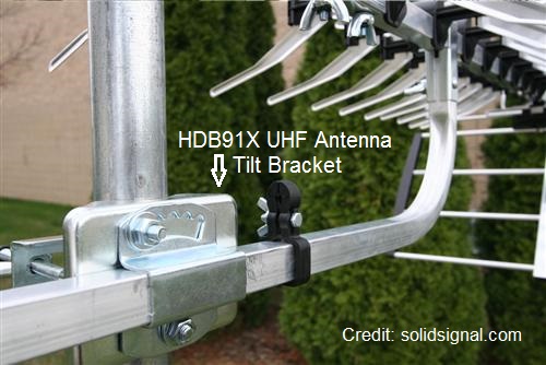

Old 22-Oct-2016, 1:38 AM   #18
If you want to experiment with another antenna for WFSB, I suggest the Antennas Direct 91XG or the Solid Signal HDB91X. They both have a tilt feature that allows you to tilt the front of the antenna up to capture the signal coming down from the crest of a hill. I have received several reports that it made reception possible, which otherwise was impossible.
Old 22-Oct-2016, 2:22 PM   #19
richardrosa
Join Date: Sep 2016
Posts: 21
Thanx for all the technical info. I gotta be more diligent on web-page link clicking. Didn't realize that terrain maps were available. I DID find the coverage maps, but they didn't always agree with what I was receiving .
As per co-channel on WFSB: If I COULD get WCBS out of NYC, that would be great, but I haven't been able to pull ANY signal at all from the south. When I was setting up these antennas, I tried pointing the antennas in the southerly direction, and got NO discernible signal on channel 33, or any other NYC channel. Point it east (at least in the morning), and WFSB came in strong. To my south are hills, mountains and neighbour’s houses, all quite higher than my mast.
The VHF antenna I have also has a 'tilt' adjuster. I didn't bother with it, as I figured it might cause polarization issues, but maybe I'll give that a shot (next spring). BTW, I DID try adding an extra FM Trap in-line with the VHF antenna, but didn't seem to make any difference for Ch 10 reception.
I've convinced the boss that I need better test equipment, so I have her 'permission' to purchase a more state-of-the art signal meter. The one you recommended from Solid Signal is what I will probably go with. Looks like it has a decent spectrum display, which is what appears to be essential for DTV. Come warmer weather (I don't work on the roof in the cold), I will use it to plot a possible better location for the antennas.
Thank you again for all the help and information.
Rich

Old 22-Oct-2016, 2:37 PM   #20
Originally Posted by richardrosa View Post
This is one of the many things that drives me CRAZY about digital. Back in analogue days, intermod/crossmod was always observable, and you knew what was going on. Now all you get is "No Signal" (which is a LIE). Without a good spectrum analyser you cannot tell what is happening.
Yes, the sudden loss of the digital signal at the Digital Cliff makes it difficult to solve reception problems. With analog, we had a rough idea of the strength of the signal by how snowy it was. With digital, we don't know if it is even there, much less how strong it is, when the tuner can't pick it up during a scan.
The sudden drop off at the digital cliff is caused by the FEC, Forward Error Correction. The tuner is able to correct digital errors up to a certain point. When that limit is exceeded, the remaining errors are uncorrected and we reach the digital cliff with pixelation, picture freeze, and finally dropout.
Many people asked me how can we tell if a signal is there when the tuner doesn't pick it up? As you said, a spectrum analyzer is the ideal tool, but they are expensive. I found that even an old analog meter will do the job. I can turn on the audio and listen for the digital signal as I watch the needle on the panel meter. The digital signal is actually an analog AM signal that carries the digital information. It sounds like white noise, and I listen for an increase in noise above the noise floor.
I don't have any experience with the Solid Signal meter, and I am not certain that it will help you any more than your present meter, but it is able to measure signal quality in addition to signal strength. In the UK a CAI (Certified Aerial Installer) is required to measure signal strength AND signal quality.
The customer reviews on Amazon look OK and this review was done for SS:
http://forums.solidsignal.com/conten...ctrum-Analyzer
this is the manual from the manufacturer's site <www.emitor.se>
http://www.emitor.se/index_htm_files...2013_2_ENG.pdf
