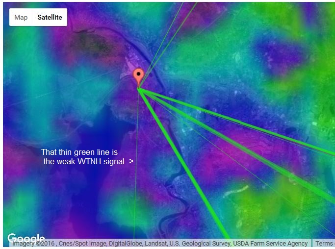

You are on the fringe of coverage for WTNH:
your location is between the blue and weaker purple signal strength:

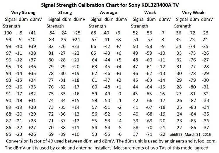

Most installers make measurements in dBmV. WGGB is listed as about -75 dBm which about -26 dBmV. That is too weak; my Sadelco DisplayMax800 signal level meter doesn't even read much below -20 dBmV for a single channel scan, but my Sadelco 719E will read lower.
I would like to see at least -10 dBmV coming out of the antenna for ABC, because OTA signals constantly vary in strength, especially 2Edge signals that are affected by atmospheric changes more than LOS signals.
You can add the antenna gain to the dBm signal power listed on the report. You can also add preamp gain, but a preamp can't be used for the strong signals because it will be overloaded and the tuner will also be overloaded.
Most tuners will drop out a signal below -85 dBm = -36 dBmV.
Here is a calibration chart I made for my Sony KDL32R400A that gives signal strength readings at the tuner. It will give you an idea of the relationship between dBm and dBmV:

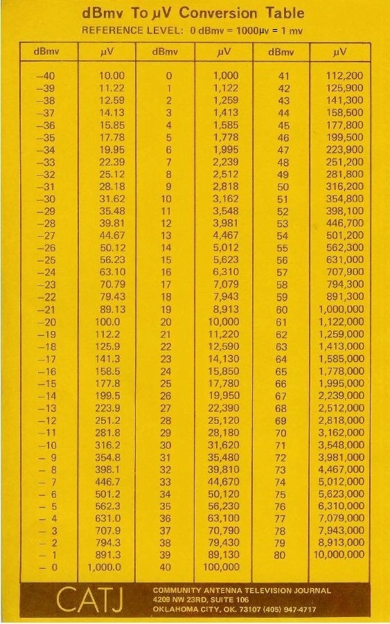

I have attached two old CATV signal level charts that your installer might like copies of.

Sorry, but this installer doesn't seem to get the concept of deep fringe reception. WTNH is a Hartford Market Station, and it should have been your first choice. Springfield is a much smaller market than Hartford, and won't offer you any Conn. News. The antenna that he brought to you has almost no VHF gain and was completely unsuitable for your installation. I also deem it unsuitable to attempt to pick up a strong station from the back of an antenna, as it risks the multipath problems that you experienced with WTIC.
You do not need a deep-fringe UHF antenna aimed at Springfield; you need a small UHF antenna aimed at the Farmington towers, and a large VHF yagi aimed at WTNH's transmitter in New Haven. If you like, because I am pretty close to you, I would be happy to design an antenna system for you, and have your installer put it up.
I don't climb ladders any longer because of diabetic neuropathy, but I can still provide good advice.
