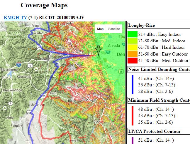

There is a hill in the signal path:
http://www.tvfool.com/?option=com_wr...dALLTV%26n%3d6
and the transmitting antenna has a directional pattern that puts you in a dead zone:
http://www.rabbitears.info/contour.p...=1389485&map=Y
I hope you like PBS.
But ABC might be possible on K20JG; do you get it?
