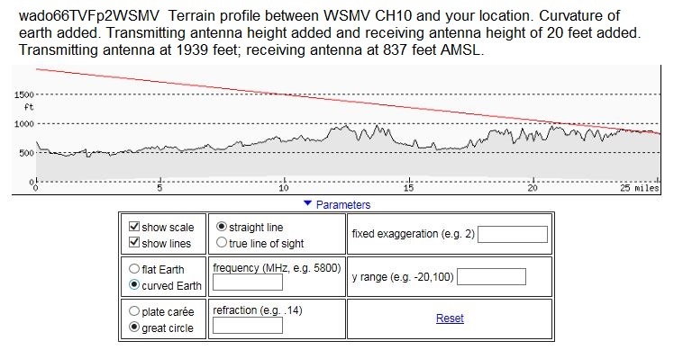

Secondly, how do I read the image below?
Is my house on the left or right of the screenshot? What does the red, yellow and green mean?
Just confusing to me.

Your location is represented as the point in the lower right where the gray (ground) meets the color. The broadcast antenna is represented by the white point near the upper left of the image.

Also note that the elevation profile, (not topo), is exaggerated to highlight the various hills, (terrain), between you and the tower. It will not show buildings and houses or any man made obstacle.
The colors indicate the signal strength, white being the strongest, blue/purple the weakest.

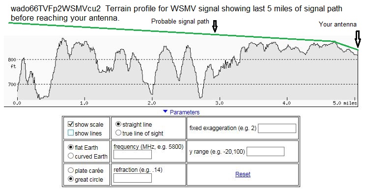

It looks like the WSMV signal grazes the terrain just before reaching your antenna. Any trees or buildings would affect it; the tvfool report doesn't take them into consideration.
That hill doesn't do any good for the signal:
