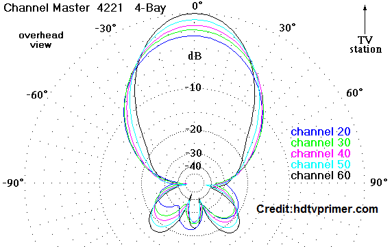

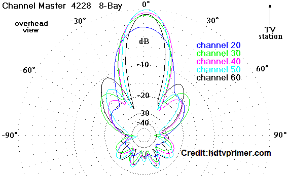

Here are the patterns of the original 4221 and 4228:
You can see that the 4228 beamwidth is much more narrow, AND there is a null each side of center where the other direction (about 22 deg difference) falls to make the other signals much weaker.
You would have been better off getting the 4221HD or the Antennas Direct DB4e, and aiming between.

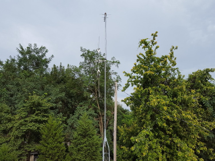

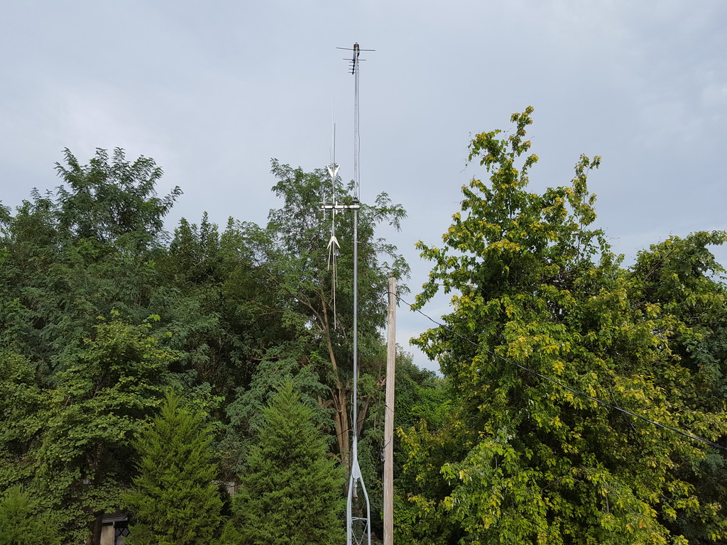

Attached is a pic showing the direction the antenna is pointing. The antenna is about 30ish feet high. The trees are about 100 feet away.

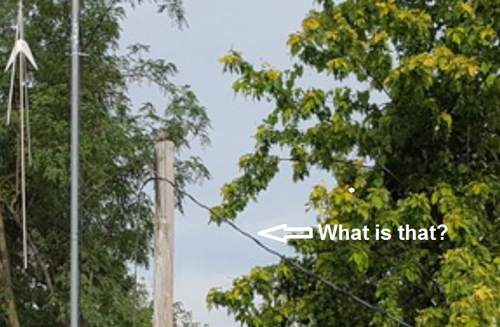

Thank you for the photo; it helps a lot.
I was wondering about that wire. Is it a power line wire? If it is close to the antenna and you have a high level of power line noise, it might affect TV reception, but it is more likely to affect VHF (ABC) before it would affect UHF.

That is a powerline that went to a house next door. That house is gone and that powerline goes to a pole on the opposite side of my yard but is disconnected. There won't be another house there.
