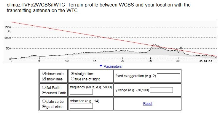

No stations have moved to 1 WTC, TVFool's data is incorrect. Previously reported (twice) - http://forum.tvfool.com/showthread.php?t=15734 The only broadcast that have taken place from 1WTC were experimental and temporary - so far.
FWIW, it's only a 3° difference in azimuth between the ESB and 1WTC from where your report is located.

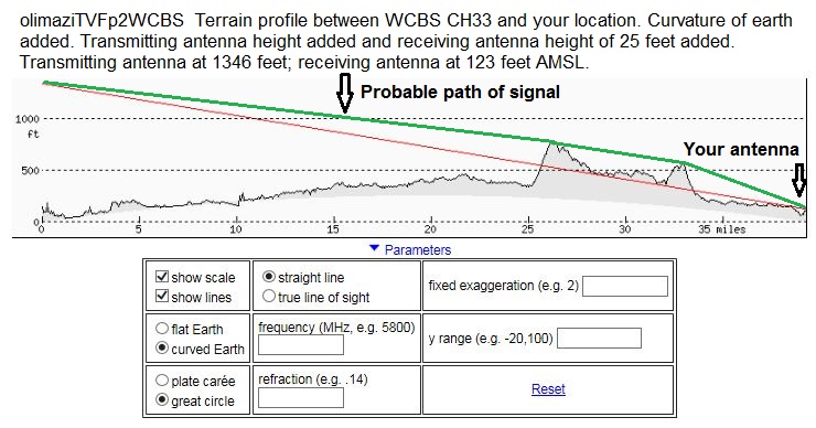

You have a mountain in the signal path:

Thank you Adtech and Rabbit... been getting solid signal on all channels for 5+ years on this setup, thought it may be the towers - 2.1 has dropped in signal strength significantly... will have to get on the roof and do a little re-aiming.
Looks like the front of my antenna had dropped down a bit... birds, superstorms, etc.
Would it be beneficial, given the signal path, to point my antenna slightly upwards?

Old 15-Aug-2016, 5:43 PM   #5
That often helps in a location like you have.
